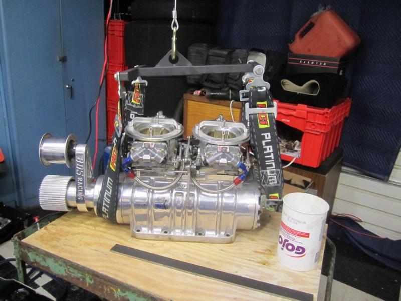

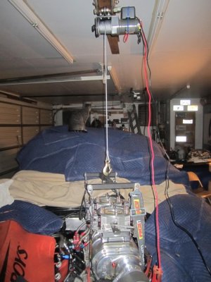

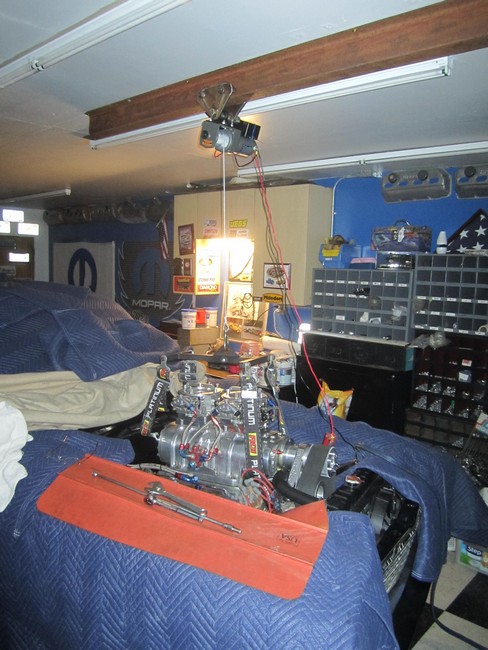

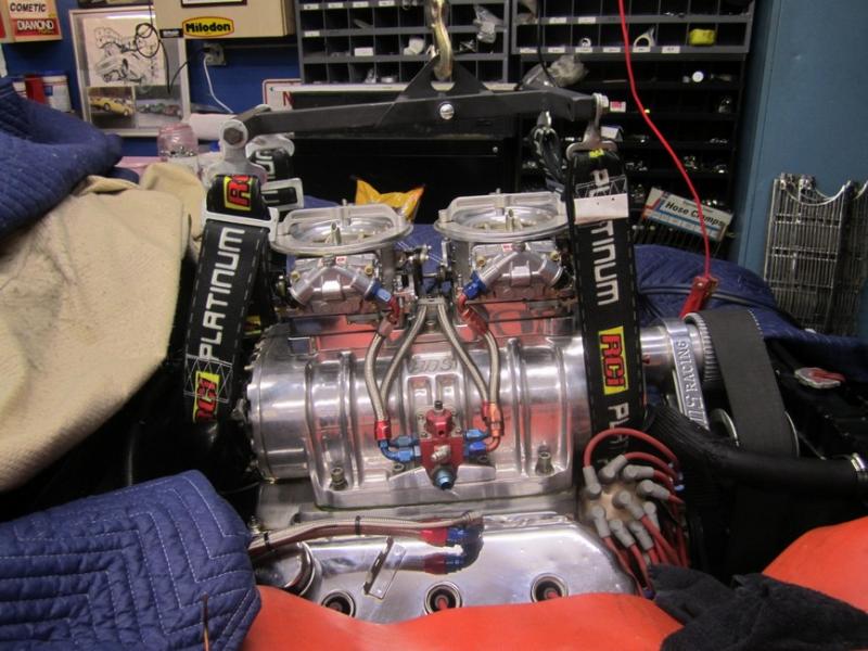

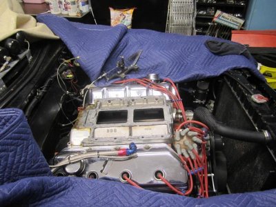

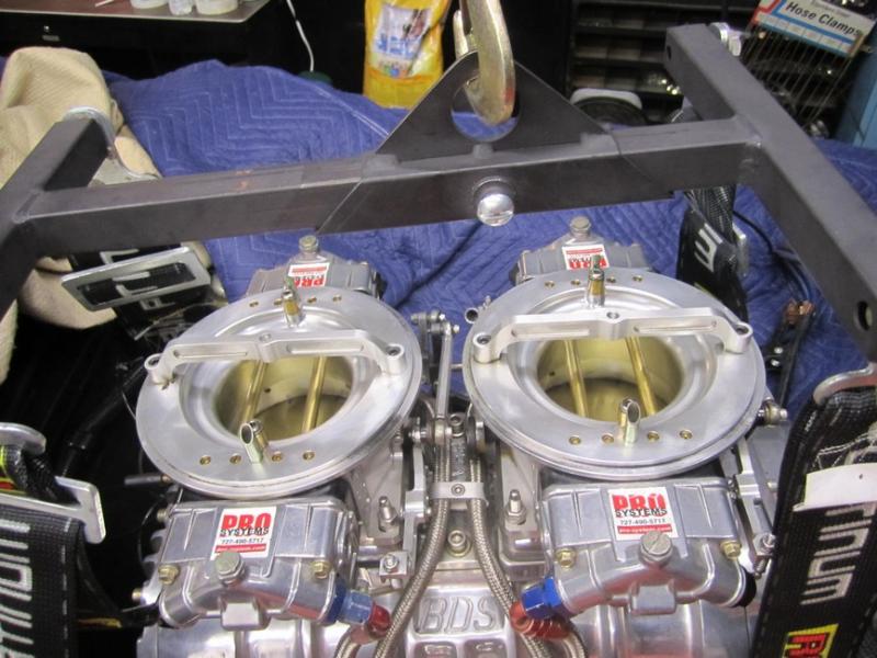

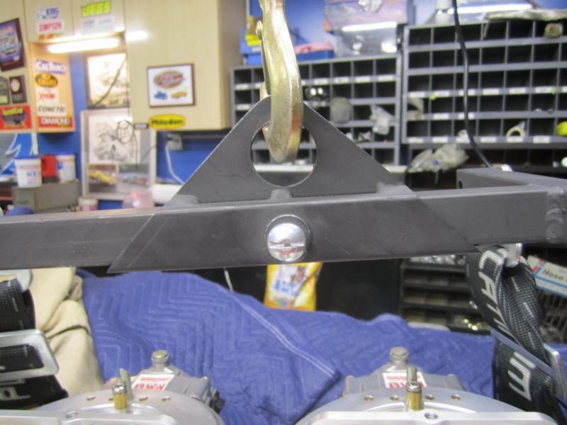

Before,I needed 3 or 4 friends to come over when I needed to pull the blower.Now I can do it myself with the press of a remote control.
Big thanks to my buddie Ken for suppying & installing the "I" beam.Harbor freight had a sale on a 2500lb winch,haddta buy it,,,,,,,,no brainer!! You can figure out the rest.
Now I want to find a stud kit to remount the blower with SUPERPERFORMANCE gaskets.
Also want to "o-ring" the top of the intake to eliminate that $14 gasket:toothy6:

Creativity and ingenuity . . . Great job . . . Neat looking "tool" to boot . . . Thanks for sharing your great idea !

Do you have stops on that I beam to prevent a big dent on the roof?
Looks like it service it's purpose but there are a few things to consider when doing something like this.
1. Harbor Freight winches of this size are not designed to lift vertical loads.
2. There are no support columns under the I-Beam to support the weight placed on it leaving only the ceiling or roof to support the load.
So please for your own safety and that of others when doing this just because the winch is capable of pulling 2500 lbs. your roof or ceiling and the winch may not be capable of supporting it.
That beats standing on the inner fenders, lifting it off, and balancing it on the core support. his I beam has load spread across several trusses. I use the harbor freight winch to pick up engines and put them in my loft, never an issue.
Thanks for your thoughts,see DVW's reply!
Doug
Right you are Doug,but I would NEVER lift my iron headed hemi with chinese winch!

Nice lift setup, I love it when a plan comes together. I use those harbor freight moving blankets for my car too, aren't they great for that? Also for kitty cat scratch prevention!
This is totally cool Dude !! I've been contemplating the same idea !!
