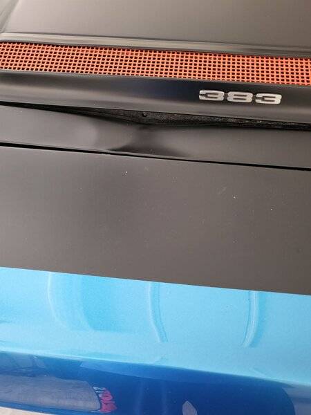

I was driving down the road in my 69 RR and the hood flew up! It bent on both sides, can this be fixed or do I need to get a new hood? See pics.
What a bummer! I feel your pain on that one. They say anything can be repaired but my guess is there's more damage than just what I see in those photos. Hope you have comprehensive coverage on your insurance, which normally has a much lower deductible than your collision coverage, as that's what it would be covered under. I would suggest reporting the loss to your insurer and taking your car to a (very) good body shop and have them write an estimate on the repair cost. They will most likely write it up for a new hood.
I would want a new hood... The saving grace? That blackout treatment.... You only have a stripe of blue that needs to butt match & if it's not perfect very few would notice... Take this opportunity to use Organisol to re-spray the black out....

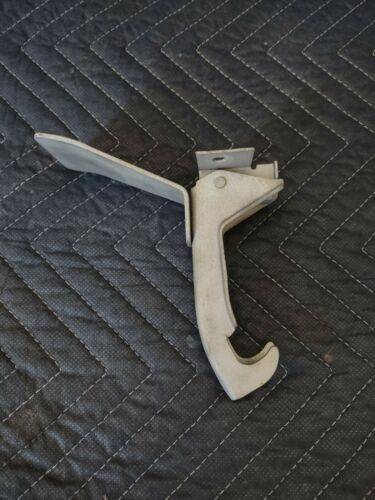

So the latch failed, and the safety hook didn't catch it? Better figure out what caused the double failure. That is a really crappy thing to have happen to a nice car!
Yup, the safety catch should have prevented that...
I hate to ask, but have to wonder.... was the safety catch left off? Hmmm..... I know a lot of us have had bad experiences with the famous Mopar "Head Hook". LOL
Hmm I just went out and looked, is the safety latch separate from the primary latch? When I looked up hoods on AMD it said that the 68's had two latches and the 69's only one?
I'm not a body expert; but have seen a few amazing repairs done by an old body shop guy I've known for years. Think if the edge or profile is undamaged; no kinks, increases the chances of a decent repair? Worth looking into..
You mean you don't have one of these?

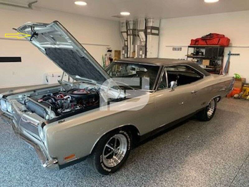

ALL B Bodies with hinged hoods have them. (Pic snagged from internet)
Definitely should have a secondary latch... Otherwise your head would be safe....

I can’t remember seeing a Chrysler product that didn’t have a safety catch for I think maybe 60 years or more.
