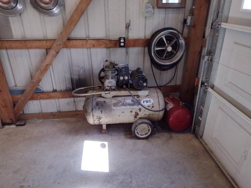

It got me to thinking about my old air compressor in my shop.
I got it several years ago. It was well used, and I didn't know anything about it's history. It has served me well for my purposes which is mainly airing up tires, occasional air impact gun use, and blowing off parts when cleaning. However, the video got me to thinking about a very bad thing I did...

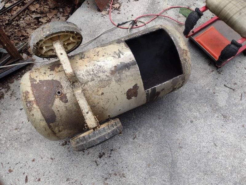

Anyway, the videos got me to thinking that I was in danger of having a similar incident. And, I usually have one of my Mopars parked right beside the compressor! So, I decided it was time to replace it. Not wanting someone else to use it, and possibly get hurt, I decided to have a look inside the tank. I performed "surgery"...

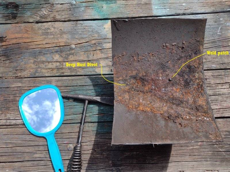

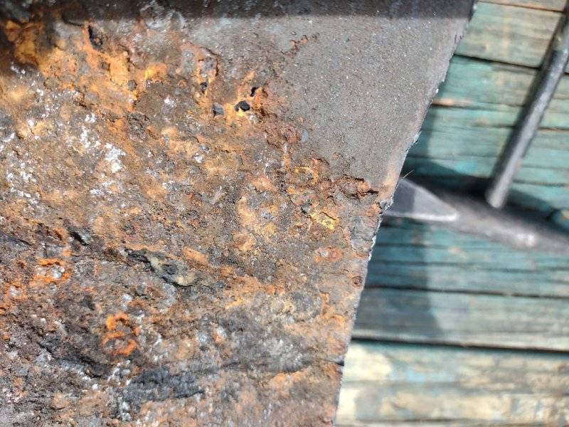

I cut out the area where the front bracket was attached, and that I had patched with my weld. Here is what the tank bottom looks like from the inside. I point out the weld penetration for the pinhole I patched. More interesting is the deep rust divot just a couple of inches away. The metal there is approximately 1/2 of the original thickness!
