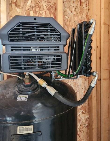

Mounted a cooler on my compressor few weeks ago, haven't used it much yet, but the temperature drop is well over a 100 degrees. My guess is I will need to mount a fan. Put it on rollers to move it out of the corner need be. Had problems when sand blasting with clogging. Planning some painting too so will see how this works..
