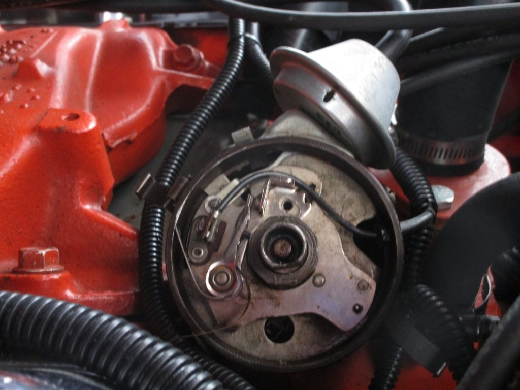

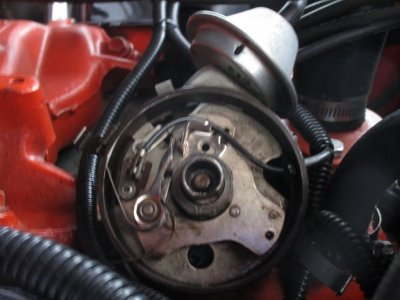

I have a couple of photos of the of the inside of the distributor, this should help with determining the kind is points I'm looking for. There is only one post for the points not 2 that would indicated dual points.
Again, I'm trying to find out where to get points for the car.
