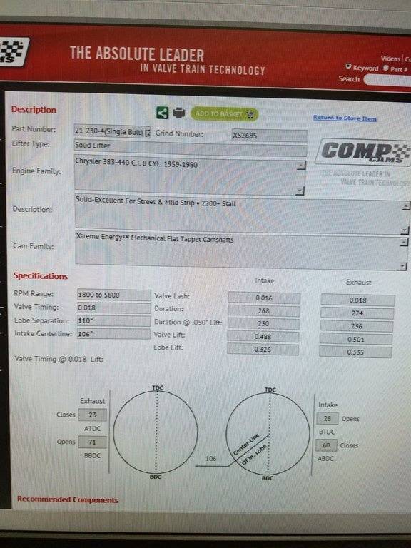

I worked under a master mechanic on my first job, turning wrenches. He advised me to stay away from the high-performance stuff, it will only cause you pain if the customer blows a job up, due to his reckless operation. I pretty much followed that advice in the sixteen years I worked in the trade. So learning about this particular aspect of engine building never came up. I have a 78' 440 that has low miles and needs freshening up. I want a non-stock cam, flat tappet as this is a budget build. I want just a step above stock, that sounds good and gives me some performance, but don't eat a lot of gas. This is just a toy for me, nothing serious. I posted the Jeggs catalog page below. Please advise me.

Agreed, I'm running a Comp 268 in my 456 stroker and really like it. I'm running their solid lift cam instead of hyd and would never go back, seams to need very little adjustments and is very quite (as far as tapping). It's a very well rounded cam for the street but a noticeable idle and strong acceleration in the midrange. I chose this particular cam because of my 6 speed tranny with a .5 6th gear, it has to be happy cruising in the 2,000 rpm range give or take a few. Had I been running a 727 with my 3:55s I likely would have went another step up but love it the way it is. Nothing but rubber threw 1st and 2nd and a hard pull all the way to 6,000 rpm.
