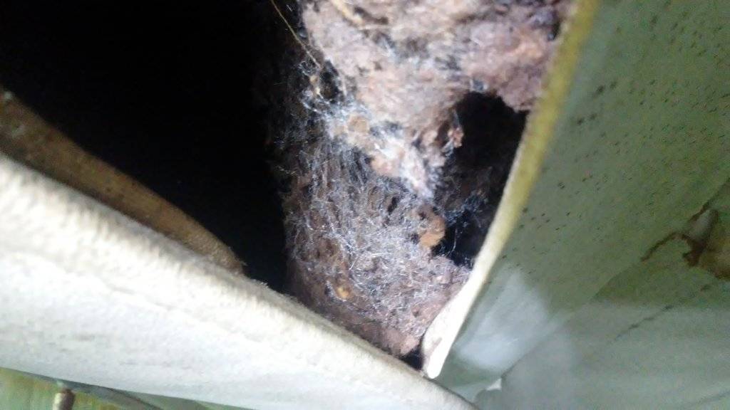

I've had this question for a Long time... Its the question of:
Asbestos in the headliner. White Crysotile Asbestos in appearance looks like fiberglass. As seen here: it appears to look like a fiberglass type material in the headliner of my 71 Satellite. It is Also the same in my 70 GTX and in the 71 Charger of my dads ( in the 71 charger it is still rolled tight as it was released from the factory... ) Heres the kicker: the material looks different in the 70 Charger. The 70 Charger didn't have a vinyl roof. While im not sure if its Asbestos in the 70 charger or not because it appears to be some type of fibers there too and im not sure if mopars having vinyl roofs have anything to do with it, but... The other 3 Mopars Did receive vinyl roofs. The 2 Plymouths Both receiving Full vinyl roofs... This question has been on my mind for So Long and ive spoken over comment to 2 guys over the years in a youtube comment section who said they sent a partial to the lab and it came back negative and assured me that it Wasn't Asbestos. Im more nervous than a cat in a room full of rocking chairs over this situation... Any Advice and thoughts about this Mopar Members? Thank You!
I know of NO asbestos in your car
Brake Pads did carry asbestos at one time (maybe some still do?)
NO ASBESTOS In my opinion

So they sent a partial piece of yours to a lab?
I have not heard of asbestos in the headliner, carpet, under dash, package tray jute.....

Thank you for the information Friends! Its a Big help!
They sent some of theirs to a lab and flat foot out said: No, there is no asbestos. Kind of like they were Ordering it to me like someone had asked them many times before and they were sick of it. Thank you for the Advice Friend!
Send a piece of yours to the lab and be done with your worries...
Amen to that Friend! I found a site thatll test them for $30 bucks a piece. I've got a line on another 70 Charger that i can hopefully get so im going to get $200 bucks up cause i also want to test the liner in that 63 merc. Thanks, Oh and one more question: if it is Asbestos and i have to remove it myself do i need some kind of clothing equipment? Like a hazmat suit and one of those masks like in the picture above?

Yep, i would sit it them No problem: asbestos can just sit there and it isnt harmful... But when i first found out asbestos could be a factor to the insides of the car... 9 stage paranoia kicked in, Oh: What's Lisa's Friend?
If you find that the test are positive for asbestos then you should have a professional remove it. It's a very extensive process and not recommended for someone that hasn't had the proper training or have the proper equipment.
I'm doubtful that insulation would contain asbestos but you never know. It was normally used in high heat applications like the exhaust manifold gaskets and used in brake lining.
The thing dealing with asbestos is that once it is disturbed, one particle is so light that it can remain suspended for years. One particle is harder than a diamond and that's why once it enters the body (lungs), it cannot be broken down and dissolved.

Removal requires encapsulation and air scrubbers... a small job like a liner I'm not sure how they would do it. Federal law requires ownership of it too....
Now what's my lawyer's phone number?! I go along with KK and the others. If you dealt with it inadvertently you have problems.
