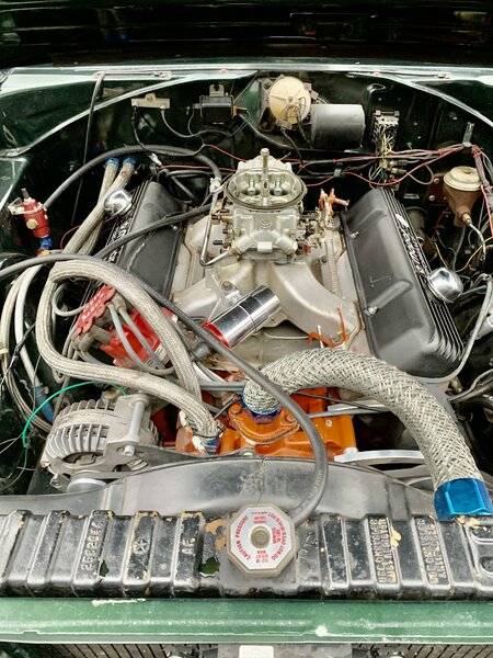

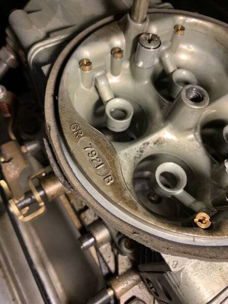

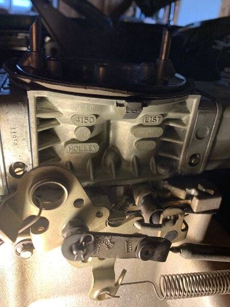

My recently purchased 66 Belvedere II has a Holley 4150 without a choke. I have to start it and stay with it for 10 minutes at least before I can put it in drive without it stalling. I'm guessing it was setup for racing or warm weather only driving? I dont know alot about this car and cannot get former owners to respond. Pictures below for reference. I want to be able to drive it in mild weather 40*-50* when its sunny. I realize with this manifold I dont have the heat risers to warm the carb. What would be a good replacement setup for my 440 to keep the performance but make it more streetable for my purposes?

thats odd I had a 750 dp on my Bee with no choke and within 3 minutes I was good to go. Go with a holley 750 I was very happy with it. I believe that carb is for racing.
Looks like a holley hp. Nice carb, I'd just warm it up like we did pre fuel injection.
I don't run chokes on any of my cars. Quite a few Quick Fuels and some Holleys. Never have had a problem after warming them up for a few minutes.
Holley markets a manual choke system that attaches to either 4150 or 4160 models. It is cable operated. ALTERNATIVELY, an electric choke system is available for the same models.....either method is vety effective and moderately priced.

LMAO @RJRENTON Did you happen to notice his Holley pictured?
@RockinRobert IMO, or what I would do is just grab a Holley with an electric choke. Many models to choose from. A simple 3310 would do. Then there is the slightly upscaled Brawler. Which is on my list of next to get.

Like davek said. I also am running a Holley 750 on my 440 with no choke. Likewise, after about 3 minutes or so, (even when it's below freezing) , it idles okay. I am running an Edelbrock CH4B intake. This setup was not chosen by me, they were on the car when I bought it. I don't mess with success. Too many other things on my list to worry about upgrading the engine presently.
