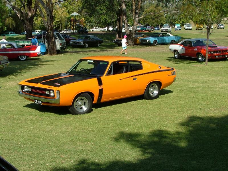

i remember them being a good engine, they used to race the hemi 6 in the valiant chargers (ugly car) against the ford falcons and holden commodore v8's the mopars used to smash them on the straights but no good on the corners
I think the Valiant Chargers are awesome lookin. You've got some screws loose. lol
if you like girls cars then sure haha, nah each there own but i cant stand there bland look, a little similiar to a 67 barracuda i reckon
