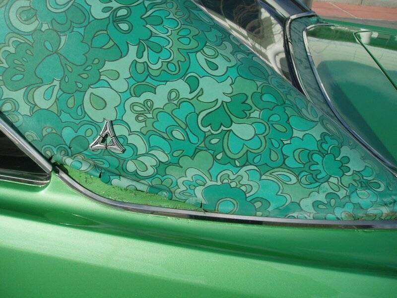

Is it possible to replace the plain painted UNORIGINAL roof for the vinyl one?
How it was changed in the first instance?
Yes you can put a vinyl on. Your going to need some trim at bottom of sail panel and maybe other places. Someone else could answer that.
Yes you can put vinyl on. Your going to need some trim at bottom of sail panel and maybe other places. Someone else could answer that.
Ok.
This can be done without a roof changing?
I mean, is the plain roof construction these same as the vinyl one?
Only add trims on top?
It sims like metal is flanged down for flush installation.
Picture only for example purpose.
Windshield A pillars might may have one each side. In my first answer asked about bubbling under vinyl top because of rust issues. The factory didn't prime or paint roofs of vinyl top cars is to save money. So putting vinyl top on a painted roof helps save the roof.
