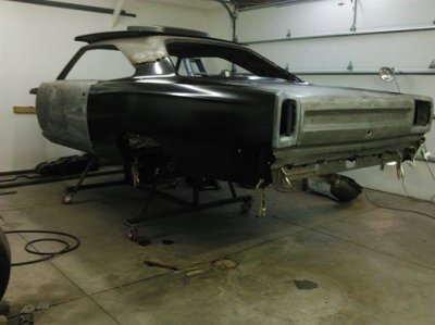

I have done this, was my first time. I got a little discouraged at first. Right up front I'll tell you that the quarters won't just lay right in there. It takes a lot of trial fitting. The bends are't very crisp and it'll take a lot of trimming fitting. That being said, if you have any body guys that can swing by once in a while to coach you, you'll do fine. I would definatley do full quarters. Mine had a vinyl top so the joint will be covered. Having done this once I can help you with some areas I would do a little differently the 2nd time around. On a good note the body shop said I did a ok job. Before you do anything make a drawing with all the measurements off the car! Let me know if I can help.
