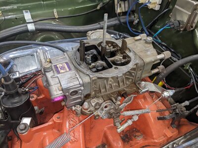

I have been chipping away at trying making this GTX a nice driver/working out some of the bugs the previous folks and father time have left this car with.. This is a real GTX and I have some documentation of history but no build sheet or fender tag. Although I can track past owners, i think.
Original engine and trans is long gone, or when I get time that is another whole avenue to investigate.. For now though originality is purely a cosmetic thing. I will attach the Holley carb pic I am taking off that has no choke horn at all. I guess a Elderbrock would look the most correct if I could get the sticker off? I have been trying to fool with Holleys and i have ok luck with them but they have their issues as a driver carb for me..
Hence my, question. Just how good are the Street Demons? They sound like pretty nice street carbs and people seem to like them? This is I have a struggle with keeping an originality look and using that carb?
Thanks for listening, Its cold out, the car needs a choke.. What are your thoughts??

Mine works good. Better than a plain Holley. That Holley looks like its straight off the Dirt track or the drag strip.

Thanks, yeah that on my car is a standard Holley body without a choke horn and they must have thought they were real tuners.. So your carb I think is the next model up demon? The one I was thinking about tying is the square one. Maybe I should look into what you have going on there? I kinda like the AFB idea of the top opening up though and no float bowls.. I have been hearing good stuff in conversation in the threads about demons but I don't know which ones specifically..
This one is pretty old, so I dont know if they even still make them like this. Its just a 650 cfm. I like it because you can adjust all 4 corners on the idle mixture,instead of just 2 on the Holleys. I used to run an originalish Carter AVS and it worked fine on the original intake. Very similar to an Edelbrock.
