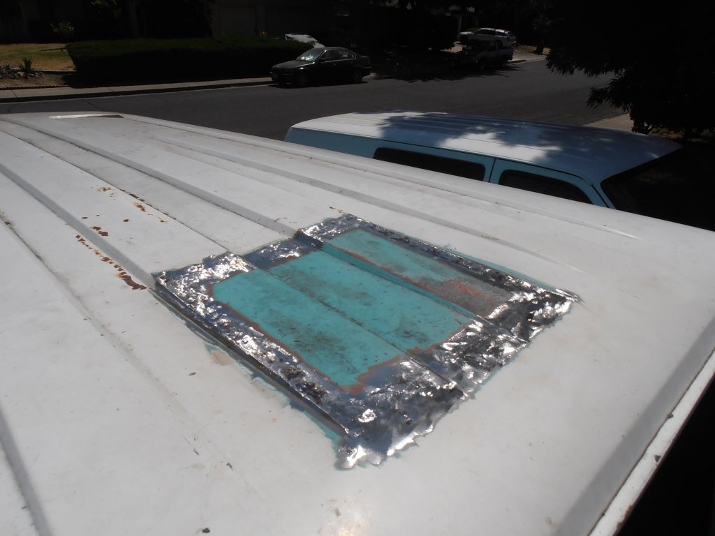

I'm spending some coin I don't have but I needed to get rid of the Pop-Up vent that was on my van, as the left coast sun would cook the plastic and I'd have to put a new one in every 2-3 years. Glad that's done as I hated it! I'm surprised by the fact that the patch panel I cut out of a Junker happened to be the same popular color on these.
I have some left over paint from when I painted it like 10+ yrs. ago, it appears to be in good shape but I'm sure I'd have to scrap the bottom out of the can to get the pigment all mixed in. I wonder if it would be a good match or would the be a line being old and off? Or should I just buy a can of white and hope it's close enough as no one would really see it unless they get up there to look.

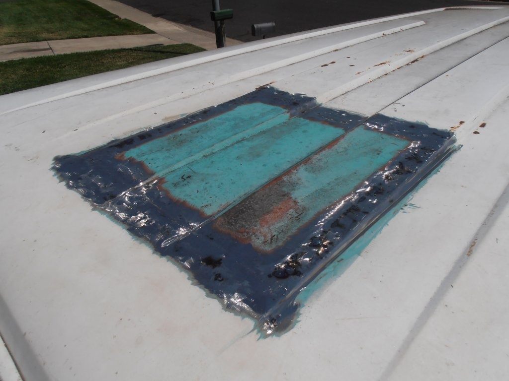

I'm thinking body color on top, but like the break up of the white. And the whit doesn't really make any cooler with the motor right next to you. Here's some pics. I know, lot's of pinholes but that's what the surface enhancer is for.

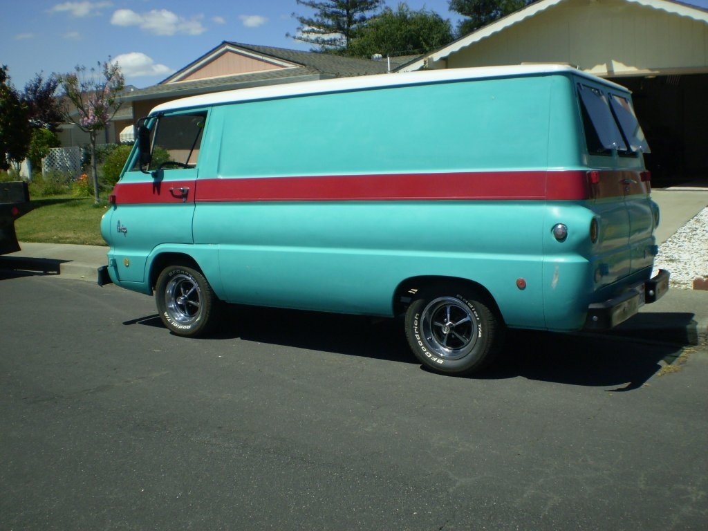

FWIW, you'll see a difference. Me, I'd grind/fill/feather/block the patch, epoxy prime... D.A. the whole roof & shoot single stage white urethane. That is a fine-lookin van. I like the white hat. My question is, what you gonna do inside ?
Cool van, I would probably just get a couple of quarts of urethane paint in the colors you need. I see a little rust starting on the top, so before it gets worse you can protect it.
Keep the white and being on a budget, buy some krylon spray paint to keep it from rusting, inside and out.
Nice looking van!
Do you have any extra "Dodge" door emblems you want to sell?
A sweet van Jon....love those A100' and 108's myself. :thumbsup:

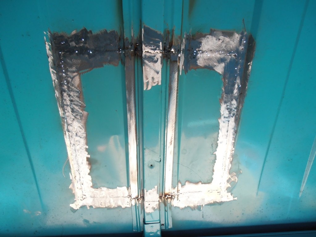

I kinda like the white myself, would kinda like to see what it'd look like being turquoise. The inside is done, KISS principle in play in the back. Plus the other rust on top has been cleaned up and that has been put into check. I just wish I knew what shade of white was used up there? No one will really see it so I guess if it's slightly off doesn't matter as much?

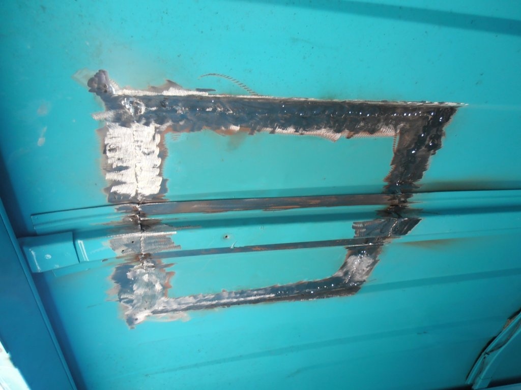

Been thinkin here, and I know that's dangerous. I do have to paint the inside where it was repaired, and like I said. I'll see how bad of a match it is on the inside and then judge from there weather to do the outside white or not. The $h!t ain't cheap either, but I did find that Valspar make a Tractor/Implement paint that's like a 1/3 of the cost of Auto paint.
But feel free to throw out ideas.
I would definitely suggest painting the inside or at the very least sealing it up.
Not sure on the Farm implement paint...I wouldnt see why not, but at 1/3 of the price you may just get what you pay for.
Do you have Ace Hardware out there in Kommiefornia? they make a great rattle can product with a nice fan spray.
I have a buddy and has painted 3-4 cars with paint he has found at Tractor Supply...he swears by it... The plus side its on the top of a van... Not many inspectors up that high...like the white too!
