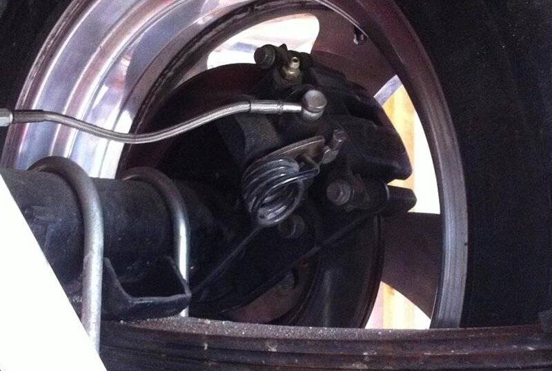

Thanks. These rear calipers are from a Ford Mustang as part of the Dr Diff kit.
Interesting, looked at the Dr Diff caliper, definitely looks like a hydraulic parking brake actuator, so not much help there, sorry.

Mustang rear calipers have the parking brake integrated into the caliper, as mentioned you need to use the parking brake to keep them adjusted.... I think your problem has been found...

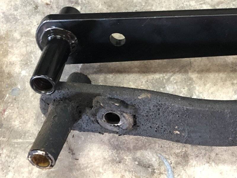

I'll restate what my situation is. I may have left something out.
Brake leverage is the only change that I have made in years.
Several years ago, I took out my stock brake pedal and hogged out the hole higher on the brake pedal arm/lever then welded a washer over it. This made a nice change in the pedal ratio and made it so less effort was needed to get the brakes to react.

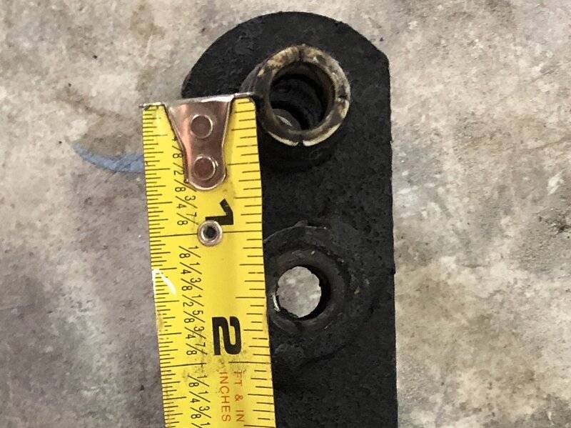

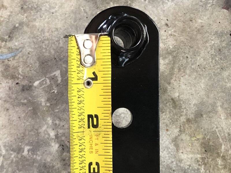

From the pivot pin center to the brake pedal pushrod hole, the automatic transmission pedal was 1 1/2"

The Manual trans pedal was at 1 3/4". That 1/4" seems to be the only difference that I can remember doing.

The easy fix as far as I can see is to modify this brake pedal lever the same way I did before. I do wish that I could find a manual master cylinder just to drop some weight and clean up the engine bay.
By the way....These Mustang calipers use a traditional cable operated parking brake.
But the cable acts on the caliper... Not on a separate drum brake setup inside the rotor... Therefore you need to operate the parking brake in order to adjust the pads out closer to the rotor.... If you don't the symptoms are a low pedal and minimal rear braking...
Agree. But you only need to apply the parking brake a few times to achieve the desired adjustment. Those Ford calipers also require a special tool to screw the piston back into their bored to replace the pads.
Back when I worked on cars regularly I would frequently get vehicles with low pedal & poor braking complaints.. Pumping the parking brake about five times then pumping the regular brake pedal & repeating that cycle 20+ times usually cured it.... Occasionally you'd get one with stuck adjusters & you'd have to put the calipers & screw the piston out.... Then you explain to the owner about using the parking brake so it doesn't happen again...
Maybe only a few times on the newer stuff... The old Mk7 & Continentals took quite a bit...
