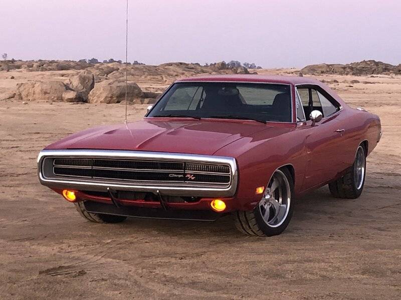

Mine work fine but after driving late model cars, I want what they are having!
The Charger affectionally known as Ginger....
The current setup is the 1975 A body knuckles, 12" Cordoba discs with a 2.75" F-M-J body iron caliper, a 10.7" rear disc with a 1.5" single piston caliper and a 1975 Dart power booster and disc/drum master cylinder. Drum/drum distribution block. It fits, it works but it could be better. When I changed to the 5 speed earlier this year, the brake pedal had to be changed. I had modified the old pedal with the pushrod hole up higher; this resulted in a more favorable pedal ratio. Now there is a slightly greater amount of free travel before the brakes start to bite.
I don't know if a bigger set of rotors and calipers would make the difference. It isn't as if I am overheating the brakes from hard use. I don't think that I have ever had brake fade with this car with this setup. I have heard suggestions that old brake hoses can bulge out under pressure. This "lost motion" would result in the calipers "seeing" a delay in pressure or even some reduction of it.

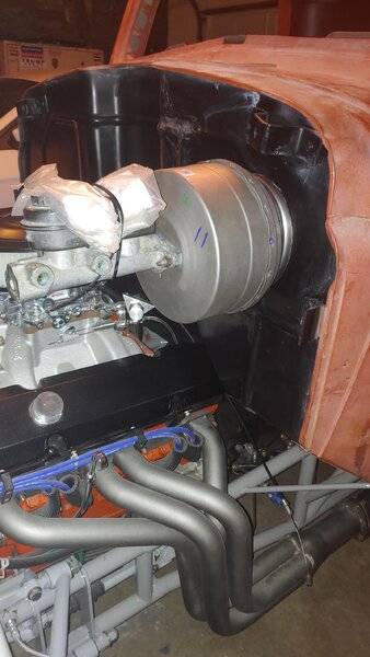

My brake hoses were replaced about 5 years ago so they should be fine. I'll check though.
I remember reading an article in Hot Rod or Car Craft many moons ago about a car that had what they called a "Quick take up" master cylinder. I have never heard of that since then.
In short, I'm wondering if there is some type of master cylinder, power or otherwise, that reacts faster than what I have. The pedal has more free play than before but when it starts to bite, it works. The pedal never gets near the floor. It never feels spongy either.
My system has no leaks. The car stops fine, it just used to stop better. I know that the disc/drum master cylinder sounds like a mismatch but it worked quite well before the pedal swap. I could pull the pedal and modify it like I did with the automatic pedal but I'm curious if there is something available that feels more like a modern car.

A dual diaphragm booster may help as they're
designed for 4 disc braking systems, and
contribute more to brake assist, and compensate
for lower than normal vacuum. Please bear in mind
that this is just my opinion, and many here
would disagree or dispute this.
I use one and have no problems.

Brake upgrade is on my back burner for now. I have disk/drum. I will be upgrading to a Hydro Boost system. One nice feature if you are using a Borgeson box, the power steering pump will supply pressure for both and by removing the vac booster, save that valuable vacuum for the engine. You really have to have a tight system since the clamping force is up to 2500psi. Also if you have older calipers you might want to replace them with new to avoid caliper spread.
