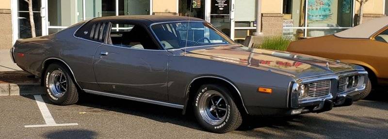

I have a 1973 Dodge Charger I want to move the front bumper in I want to hear from the guys that actually did this pictures would be great .

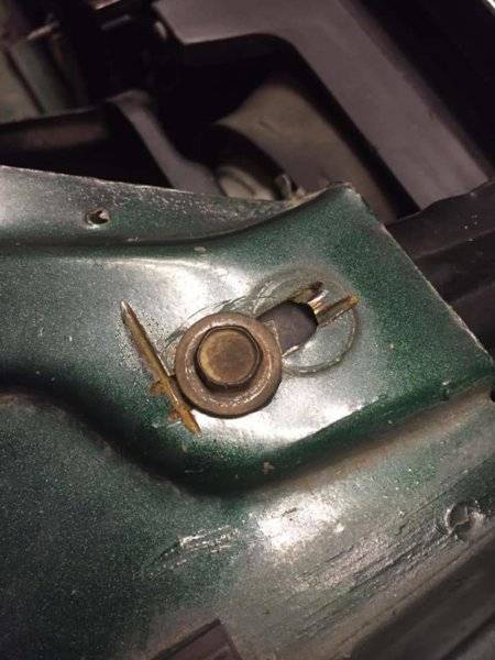

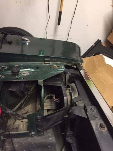

I just did this to mine. the top brackets will have to be modified as well. cut slots in the existing holes in the brackets and push it back. you may encounter interference with your grills in the headlight area. I'm using a hideaway set up so I can't speak on that part.
Headlights? They mount to a framework that mounts to the core support. It won't move back with the bumper. I have not done this mod. But I have had the front apart. It would seem that the the headlight frame would need to be modified to move the headlights back. I don't think it is that difficult if you have some sheet metal tools and a little skill.

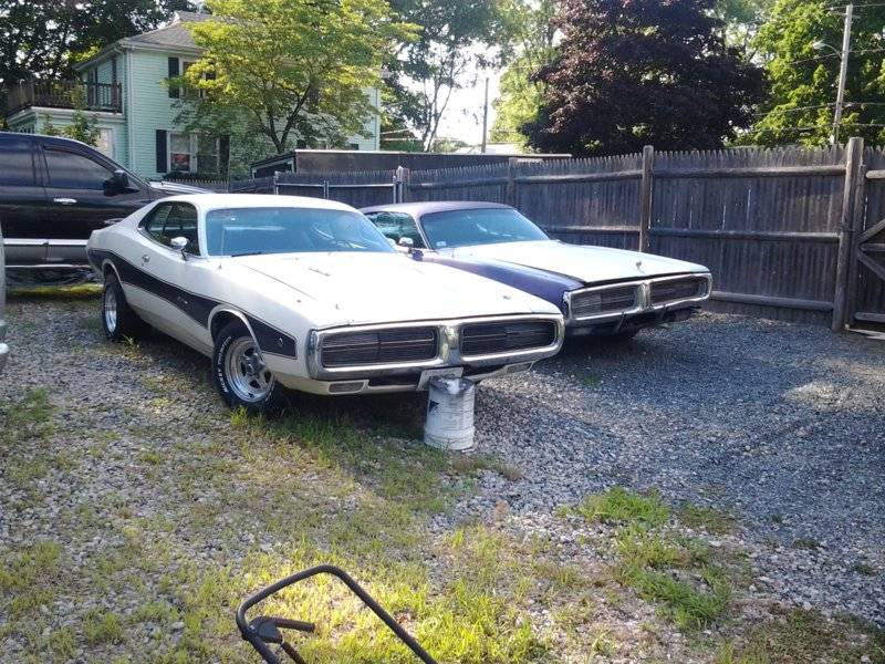

You don't need to move the headlights frame back, just trim out the headlight fillers IF REALLY necesary due the tipically contracted fillers. 71/72 headlights are at the same location with bumpers closer to body with standard grilles. Only change on headlights position is when 71/72 were hideaways, which got shorter headlights mount to get a larger gap to the doors.

Thank you this is exactly what I was looking for in a post another guy sent pics of how he did the top I appreciate every one helping.

aside is easier to replace the bracket than fix or replace the fender in any case.
on 3rd gen charger forum a guy also made a small diagonal cut mod on frame rails ends to make the bumper to get even closer to the body, mathcing with the Y brakets.
