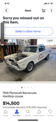

I went and bought some used steelies and this Barracuda was in the garage.

So he opens his garage/shop and he has this sitting there. He helped a friend in California and ended up with this car. I think it's a 340 and he said its best was 12's.
