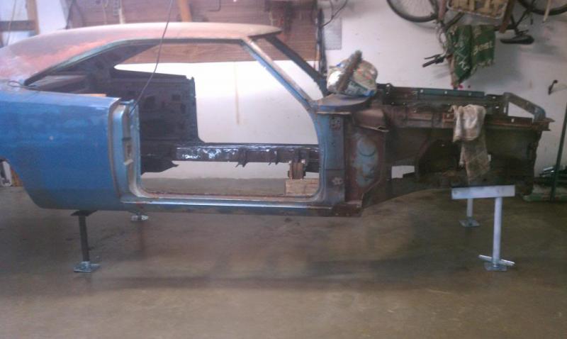

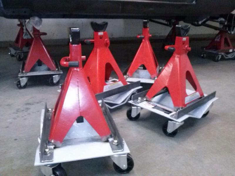

Is this high enough for ya? lol.. I made these for less than $140., bought the scaffold wheels (swivel and brake/lock) at Northern Tools, got the metal from scrap yard. I also have stationary feet that go on in place of the wheels. The feet are height adjustable. Wheels and feet were most all the expense. I have hauled it on a trailer with no probs. Tieing them together is not really necessary. Very easy and inexpensive to make. Or you can buy shorter ones from uscar tool for about $450. I also made, and sold some of, the dollie stands in the last pic which worked ok, and are handy.

Is this high enough for ya? lol.. I made these for less than $140., bought the scaffold wheels (swivel and brake/lock) at Northern Tools, got the metal from scrap yard. I also have stationary feet that go on in place of the wheels. Wheels and feet were most all the expense. I have hauled it on a trailer with no probs. Tieing them together is not really necessary. Very easy and inexpensive to make. Or you can buy shorter ones from uscar tool for about $450.

I made my front stand brackets to bolt to either the K frame mount holes or the front bumper mount holes, either way works fine. K-frame mounted is stronger but front bumper holes mounted will help the car from wanting to wheelie. Some cars can tip backwards like a wheelie sometimes if you're not careful. And you will still be able to install the K frame and front suspension if you make your stands bolt to the bumper holes. Sorry don't have pic of the fronts. Also note that the rolling dollie jack stands (the red ones) are handy when you put the rear suspension on the car, which would keep you from being able to use the bolt on stands. Same for K frame and front suspension unless the fronts stands are in the bumper holes.

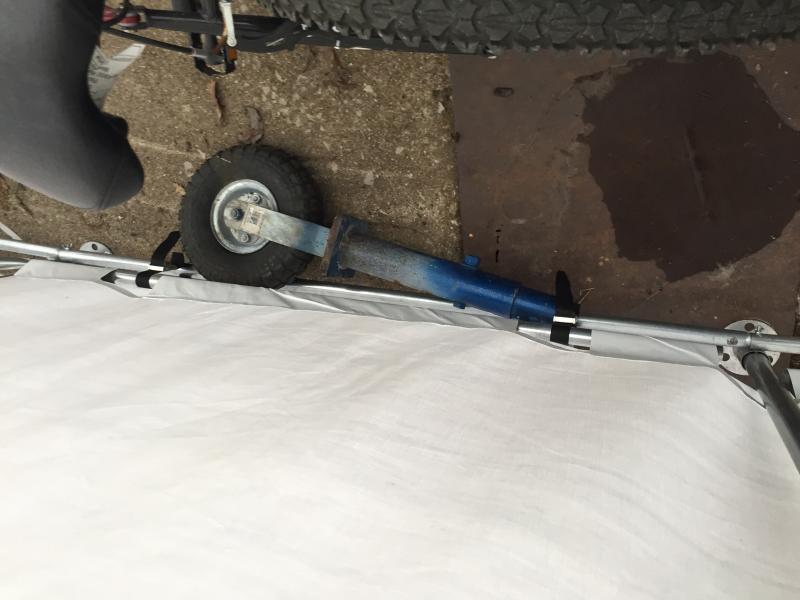

Matt where you at in Illinois? I'm in Trenton IL near Scott AFB. I just picked up a set off craigslist and if close could use them as a pattern to make some. These bolt to front bumper brackets and rear spring area. Are adjustable also.
i actually just found some casters i took off an old welding table and will be making the brackets/mounts here early next week. thank you for the post and reply tho! all you guys been so helpful. i really don't know how long they will be on my car so to borrow would not be the right thing to do. To get the dims ill just make a cardboard cutout and punch them out at work. really appreciate the offer tho man!

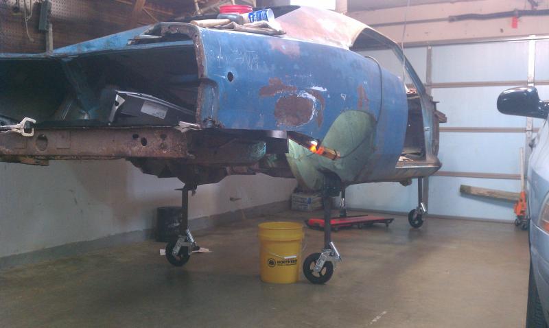

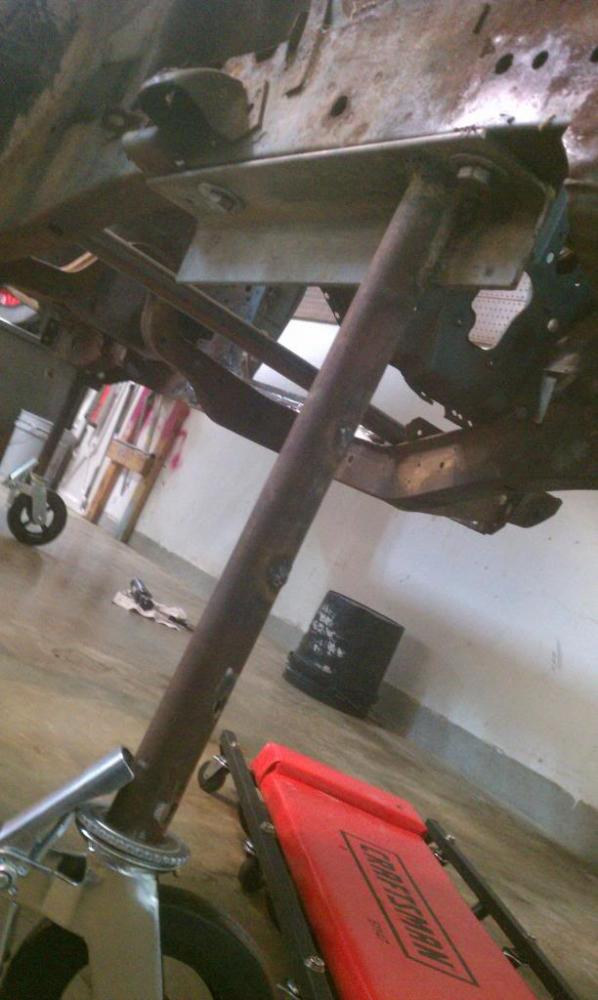

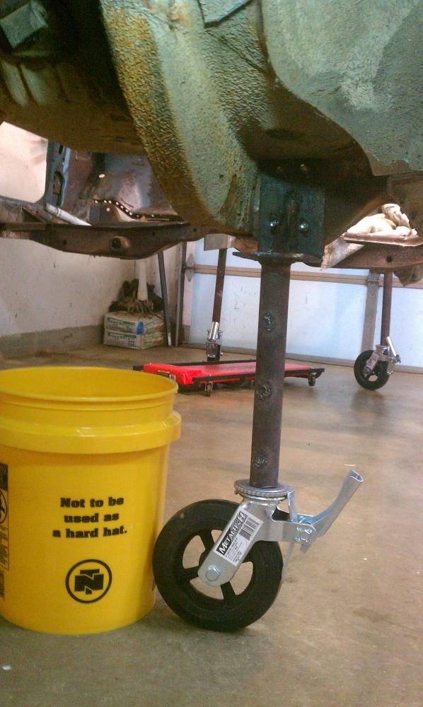

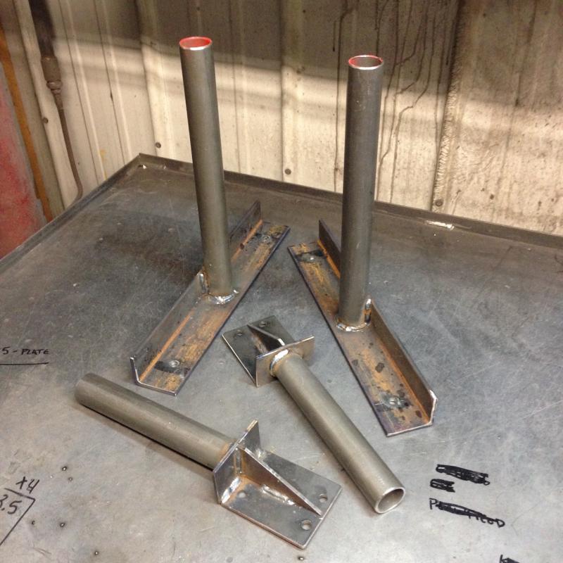

threw these together with some cutoffs from work. Found some scaffolding casters off a old welding table as well. Ill be putting them on soon. Thanks for all the help guys!

Nice! Those look better/prettier than my old rusty scrap metal ones, I'm jealous. Maybe you did already, but I'd weld those gussets all the way up. Found a pic of my fronts mounted to K frame spots (before I drilled holes for bumper bracket mount). You may want to weld the mounting nuts on the rear stands. It makes them a lot easier to install. I installed my rear stands before welding the nuts on, then tack welded them after tightening to make sure they were lined up right.

Yeah i was thinking the same thing. Rather be safe than sorry.
keep it strong.
