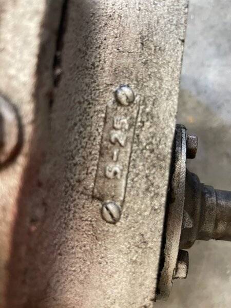

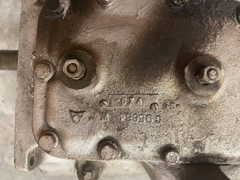

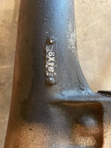

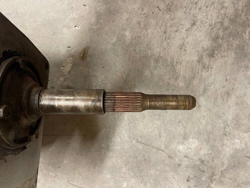

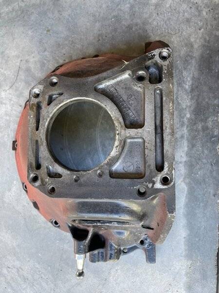

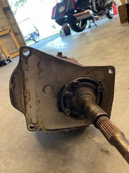

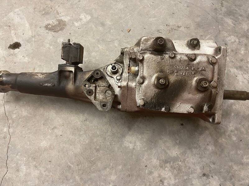

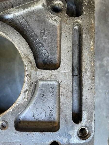

Here are pictures of the bell housing and views of the tranny. Can anyone shed some light on what I have here? Thanks in advance, Joel
Bell housing is a 69-71 small block 10.5” aluminum.
we need photos of the trans, the complete tail housing from the drivers side and the main case from the passenger side.
Agree we need pics of the whole trans it looks aluminum and unless it’s the holy grail nascar it’s an O.D. gearbox.
The front bearing retainer is small, and so is the hole in the bell housing, so it’s not an OD trans. The front of the case is so clean it looks like aluminum.
I would have to agree but the bearing retainer could have been changed and the bell is not an OD bell housing.

Thanks, On the bell housing.... is it small block only or can it be used with a big block? I'm trying to figure out what is the most cost effective way to re-do this car. I've more or less heard that big block bell housings are scarce and very costly, so my thinking was to stay small block.. do I have this correct?

Small block only on the bell the gearbox can be used on small or big block

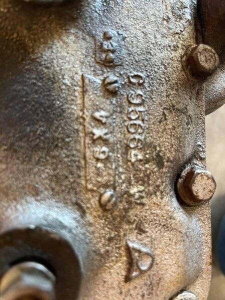

I see a 1966-1967 trans. You will need a 66-67 bellhousing or get/make an adapter ring for a 68 and newer BB bellhousing.
1965 trans has the small speedo gear housing, that one has the 1966 and up style.
Question, don’t all 1965 4 speeds have a ball & trunion flange on the output.
Yes your exactly right all 65 were ball and trunion so by the casting number and no flat pad looks like an early 66 then. 97372 would be late 66 thru 68
