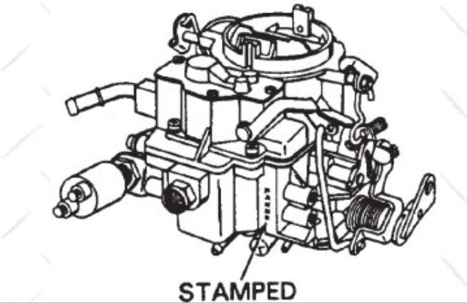

The carburetor pictured is a Holley model 2280 two barrel. The Holley 2280 was first used on the 318 in 1978 in passenger cars and in 1980 in trucks. The pictured carburetor was originally used in an Electronic Lean Burn (ELB) application due to the presence of the Throttle Position Transducer (orange cylinder with two connections) and the wiring with blue connector for the ground switch/idle stop.
The sticker on the upper cover with the bar code is the Chrysler part number. The Holley list number can be found on the front left of the lower body:
The Holley list number will look similar to "R-8448".
If you provide the Chrysler number (which is not quite readable in the picture), and/or the Holley list number, I can tell you more specifically the original application for the carburetor.
Because the bar code is still present, the carburetor has likely not gone through a mass rebuilder process.
The following image is a 1978 318 with the Holley 2280 carburetor and the original factory throttle and kickdown bracket.
