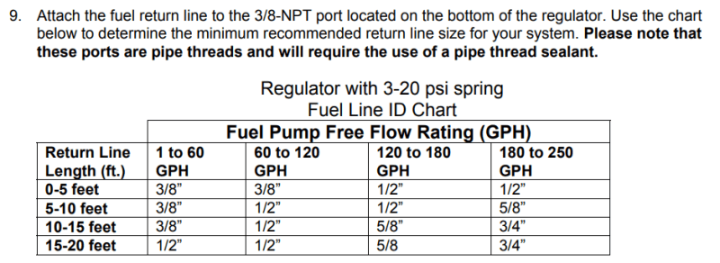

This is in the Aeromotive 13301 fuel pressure regulator installation instructions. Now, if you're not using a regulator, then I would agree the return line could be smaller, but with the regulator controlling system pressure, it's supposed to be return line is equal to or larger than the supply line.
