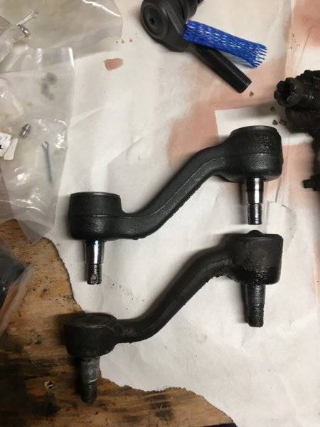

The idler arm had a slight difference in shape and it made the center link closer to the pan. You probably won't have that problem. Looks like you have the small block engine (Poly).

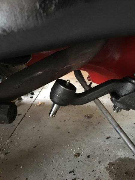

Side by side they look the same however once I put it one it is hitting the exhaust

You can see the difference in the profile. Don't know why anyone would change it from the original but it's what some of us have found.
Your solution would be to dent the header for clearance. I would probably mock up or just install and snug up the other pieces and see how they clear before you break out the hammer.
I found a NOS idler when I encountered some clearance issues. The problem was the idler was holding the inner tie rod a bit higher than before and it was contacting the torsion bar. (Passenger side) The tie rod ends were a bit heavier in thickness also.

Thanks everyone. There was some play in the exhaust that I need to figure out. I’m guessing there’s a hanger missing or it’s not tightened down somewhere?? I’ll look into that tomorrow. I also don’t have these torqued down to spec yet. That may give a bit more clearance?
