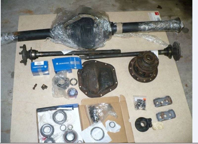

I did it but bought a housing for $50 spring perches cut off so that was a cheap start. Ebay $130 axles SG $250, had gears, had 10" brakes complete, sruds and nuts for BP $30 brake spliter $35 spring perches $45 had a yoke and rear cover. This was 20 years ago. Only way I'd do it agin if there was no other way. Never assembled it dumped it for $950. Buy Dana parts on ebay now isn't easy. Maybe swap meets which I didn't do.

Didn't have one. No gears or brakes in picture. What do you want for the $950 I sold this stuff for? Forgott $90 bucks for bearing set.
