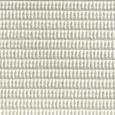

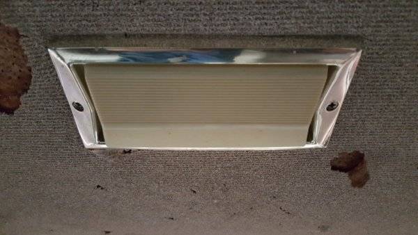

I thought I would share my experience, buying a Hardboard headliner for my '62 Dodge, Polara 500.

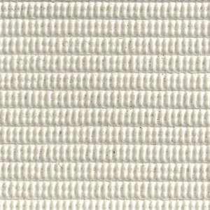

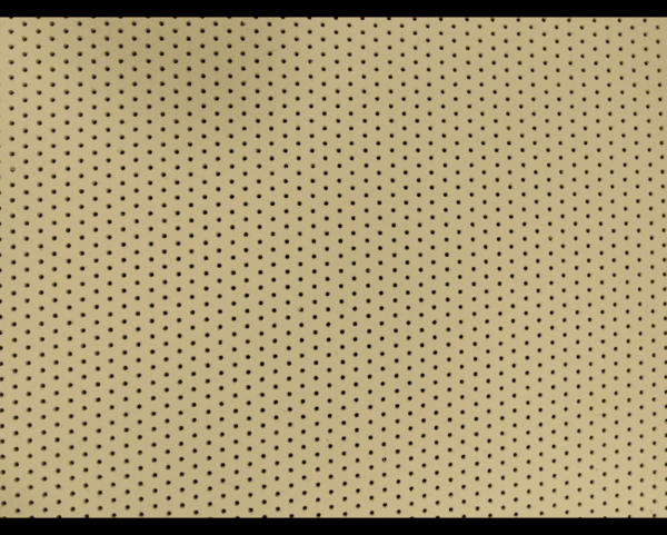

My original headliner was the hardboard type. Perforated hardboard covered with, what's called Bedford Cord. No one makes it.

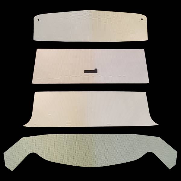

So I thought I would just change it to a cloth and bow type headliner. Doing some research, I found a hardboard one made by REM.
I talked to REM and asked if they could email me some pictures.

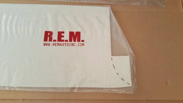

So for a little more money than a cloth, I decided to give it a try. The first one I received from REM had a damaged piece and the rear panel was cut into three pieces.
Contacted them and they stated that their cutter cut it wrong and they would replace both pieces. A couple of weeks later I received the replacements. They got smart on the piece that had been damaged and left some material there to give it some support.
Then looking at the rear piece, I find these two small pieces that appeared to have been cut from the lower corners. What's up with that?
So I contacted them once again and ask what's up with cutting the corners off of the main piece?
They explained to me that the material that they get to make these isn't long enough. Why would you even offer something if you can't make it right in the first place?
They told me to glue a backer onto it and attach the supplied pieces to the corners. I also noticed that the perforated holes aren't straight with the edge. They said they have to place the patteren on the sheet at an angle to get as much as they can out of it. Who does this ?

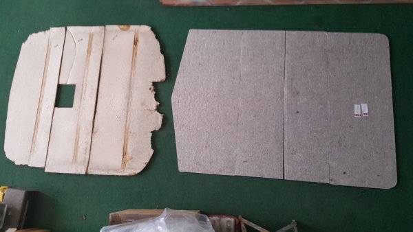

I ordered the jute insulation from them also, figuring it's precut, and that would save me some time. This is what I received. (Original on the left)
Not even close. Contacted them with pictures and they said maybe you could trim it to fit. I said I probably wouldn't have contacted you if I could. The material isn't wide enough to do that. So I'm sending it back for a refund. I'll just buy a piece big enough and cut my own.

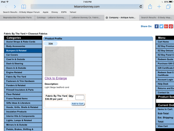

The board is untempered Masonite pegboard . Same as pegboard but flexible.
The original Bedford cord was foam backed ,I've tried to source some but nothing comes close.
Le baron Bonney use to have material/fabric that looked close (and was light beige like the originals)but I see it is no longer on there website ,I'll need to call.The larger sample is from originalauto.com but I'm not sure how it compares to the original.
Otherwise I may try and reproduce it myself with a flocking process.
If I where you I'd try and stick with the originals ,yours are pretty good especially the boards.
I would also say that demand produce's better and better supply with repo car parts.....unfortunately for us we are rare group.

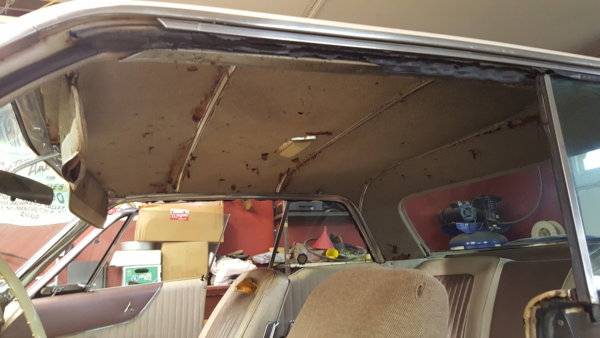

View attachment 566589 View attachment 566590

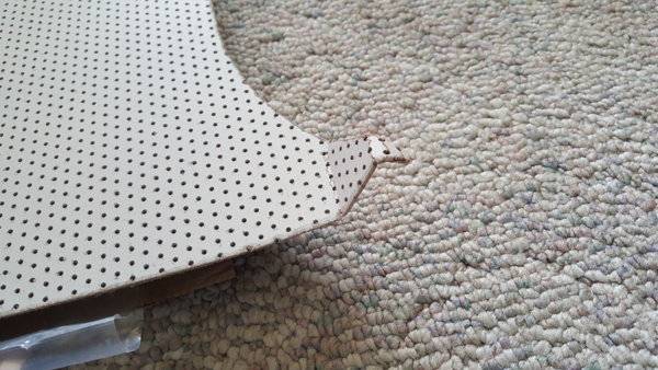

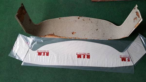

View attachment 566596 View attachment 566597

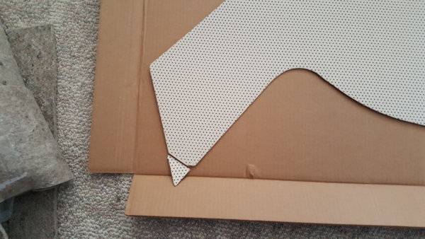

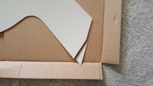

View attachment 566599 View attachment 566600

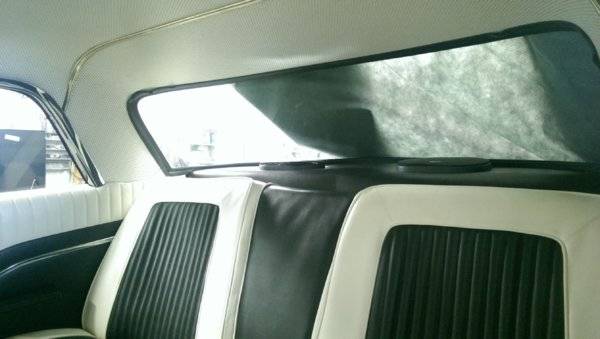

Had same stuff happen to me, corner got broke off. Bought from Joe Suchie called him and he had them send me another rear sheet, neither one had the extra pieces for the corners. I made some from first broken panel. Matched them up to large piece and it looks pretty good. I have more material if some one need some to make pieces. Didn't buy the Jute, left it out and used sound deadener on roof.
That looks real clean, being white. That's the look I'm going for. Did you paint the board or just use it the way it was? Also how did you attach the corners? I'm thinking a thin piece of cardboard onto the back then line up the small piece to the larger. Using clear two part epoxy.
How did the install go. Was it flexible enough to just pop it in place or did you use heat or steam to get it to form for you?
I have an upholstery guy that keeps the jute. If I ever get ahold of him I'll use that. If not I'm going with the foil sound deadener. Too freaken cold in the garage for gluing right now anyway.
No Paint that's the way it comes, exactly the way I attached no heat gun, no problem.
no jute just foil sound deader

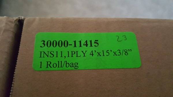

So after ordering the jute insulation from REM and it not being correct, I did some shopping around and found some on Home Depot's site. They don't have it in stock, you have to order it online.
https://www.homedepot.com/p/UltraTouch-48-in-x-24-ft-Radiant-Barrier-30000-11424/100661257
It took a week to receive it, being shipped from Arizona. So I open the box and it really looks like a nice product.
Then I did a double take on how much I had received. Here's my invoice.
Here's what I get...
I'm really getting tired of all this incompetence! I called and they gave me the runaround about what they should do. "Send it back and they will send the right one". I'm not going through all of that! It's their mistake and they need to make it right. So after going around and around with them, they finally told me to keep it and they're sending me a $55. coupon (via email) to put towards a reorder or whatever I want to use it toward. Geeesh!
