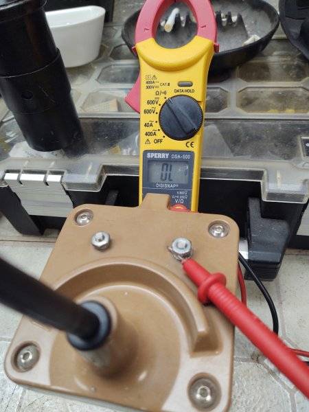

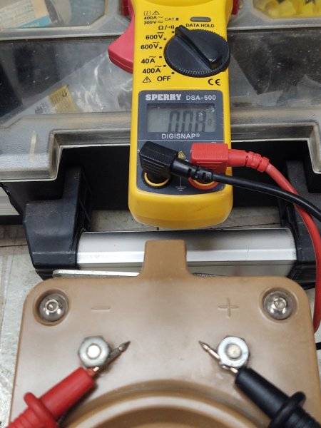

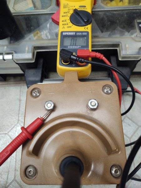

Coil in question is one of the old yellow "square" Accel coils....
Am I losing it or does it mean the coil is bad if there is no continuity between either of the primary leads and the big secondary
("coil wire") outlet?
Continuity only between the Neg & Pos terminals on the coil. The High voltage terminal (Coil wire) is completely isolated from the other two. No continuity.

What kind of meter, and on what setting are you testing with?

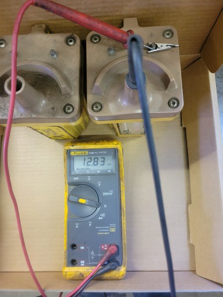

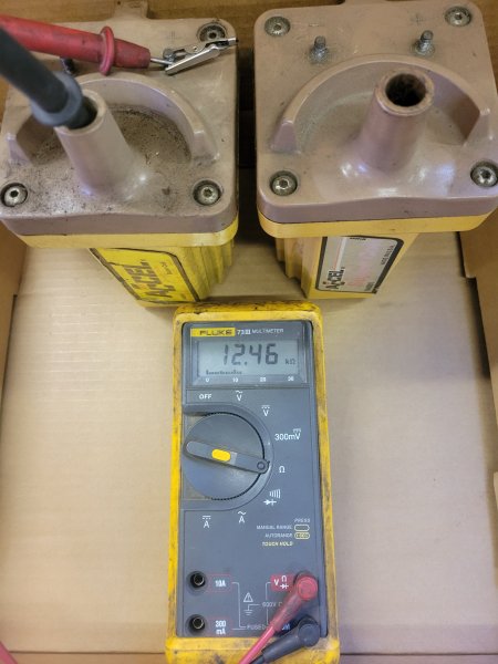

Whenever I have tested a good coil , I’ve gotten in the neighborhood of one and half ohms on the primary side and 9 kilo ohms from positive and negative to the secondary.
I believe Sometimes advice comes off sounding like criticism but either way , you can still learn something
The ohms function is for DIODE testing. It's best suited for a clamp on ammeter or voltage testing both ac and dc. I don't think it has the capability of testing high value ohms like the coil's secondary. A better DMM is a FLUKE # 117 with total auto ranging of resistance, voltage and current plus diode testing.
Typical Accel coil's have a very low resistance primary and a high secondary resistance...above 10k ohms to produce the high secondary voltage (volts to turn ratio between the primary and secondary). Perhaps you should consider a different digital meter???? Just my opinion of course.....
