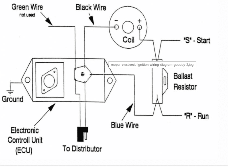

Make sure the ignition box is being fed 12 volts. The feed needs to come from the side of the ballast resistor with the single blue wire (R wire in diagram). Not the side that has the blue and brown wire (brown S wire in diagram). Easy check. Disconnect the ballast resistor. Turn the key to the run position. There should be power at the box blue/yellow wire with the ballast disconnected. If not it's wired wrong.
