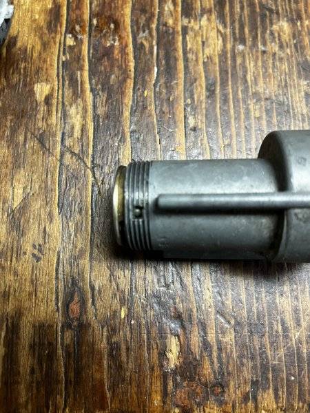

The chrome bezel needs to be removed to get to the pin. I just posted some 69 ignition switches so here is a pic of the pin that needs pushed in to release it.
