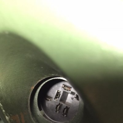

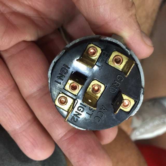

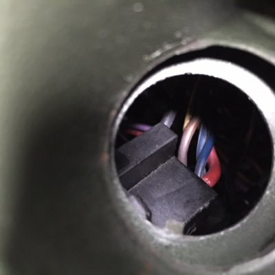

I need help figuring out why my ignition switch caused the + cable on my battery to get dangerously hot:angryfire:. It started when I noticed that when turning key to start I had to jiggle the key to find the sweet spot for it to fire up. This morning when I tried to start it the sweet spot it would just give a single fire up and not start the car. Then I noticed some smoke coming from under the dash. I immediately disconnected the + cable and noticed the battery cable was burning hot. I need this forums help to guide me through the trouble shooting of this issue. I pulled the ignition switch out and disconnected the connector to it but cannot get the connector to drop below from behind the dash to examine. Too short...any suggestions?
Connector and switch both look ok. from those angles, are you able to inspect the wiring at the connector to the harness and see if there is any obvious melting or bare copper anywhere?
Do you have a volt/ohm meter you can use to check the switch? Also what is the year and car? I will get the wiring diagrams and post them so we can trace things out.
Agree ^^ the switch and connector look good. You MIGHT have a short somewhere. Fusing in those circuits is very poor
Might be a failed switch, they don't cost much. You can remove the lock cylinder and keep your present keys. ANY of the circuits fed by the switch are at risk. If the switch is intermittent (broken inside) an ohmeter might not show up an obvious problem.
1....start wire. This is one wire, traditionally yellow, goes from switch, out the bulkhead, to your start relay. It's certainly possible the start relay developed an internal short
2....Coil bypass circuit, traditionally brown. This is a separate contact, also hot only in start, and feeds hot battery to the coil + for start. Unless the ignition system has a big problem, this might be down the list.
3...Switched accessory. This is hot in run or ACC and feeds batt voltage to the switched buss on the fuse panel. It's a short wire from the switch to the fuse panel, but if there's a problem in there "could be"
4....Ignition run, or IGN 1...Hot ONLY in "run," feeds several things under the dash and in the engine bay and IS NOT FUSED. Feeds the warning lights and I believe cluster gauges, etc, and goes through the bulkhead, feeds ignition, V regulator, depending on year feeds other smog doo dads, electric choke if used. This might be a likely suspect
