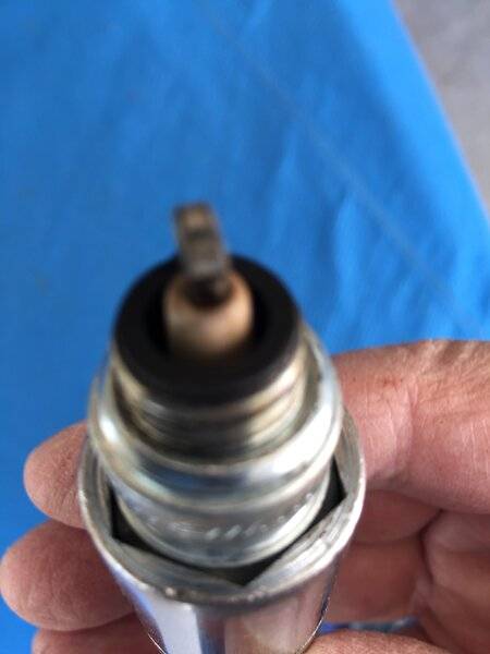

Given the champion RJ12YC as the base line what is the next step up hotter plug. Sorry to show my ignorance. This plug has probably about 50 miles on it and what I’m dealing with. Thanks for listening.

Given the champion RJ12YC as the base line what is the next step up hotter plug. Sorry to show my ignorance. This plug has probably about 50 miles on it and what I’m dealing with. Thanks for listening.View attachment 1105751
Looks like carb is too rich. Work on tuning the carb first. First part of that is checking fuel level in the fuel bowl(s)
Is it a ThermoQuad? Some of those had a problem with floats sinking with age they weren't a soldered brass float (I think)
If you were considering Champion, I would suggest J-13Y or Mopar P35P (made by Champion available on line) or AC R44S or Autolite AP86. Usually, plugs with platinum electrode(s) and most copper alloy center electrodes (Champion - C designation), have a wider heat range. NGK plugs offer many different styles and types of electrode configurations and heat ranges. Just be careful when selecting plugs as the "reach" or thread length is an extremely important consideration. MOPAR iron heads use 3/8" reach plugs; some aluminum heads use 3/4" reach plugs.

Appreciate the advice, will double check carb setting ( lean it out more) and try the hotter champion plug. Where on line are Mopar plugs?
Yes thermoquad. I very carefully rebuilt it short time ago and replaced the brass floats with phenolic ones as part of the rebuild.

Try ebay (vintage Mopar spark plugs) or Google Mopar P34P or P35P spark plugs or Champion J13Y or J14Y. Or if considering a non projected core nose plug, try Champion J-8 or AC 44 OR 45 or Autolite A7. Most are NOS "vintage" spark plugs. Some of the NOS Mopar plugs, especially the ones used in HP engines, Hemi, 340s, 440 HP, command high prices. But....look outside the normal applications....the UJ-11G and the HO-8A Champion plugs I use are for 2 Cycle applications....HO-8A were used in McCullough racing go kart applications and the UJ-11G were for some snowmobile use.....and work very well in my RS23V0A****** but this what works for me.
