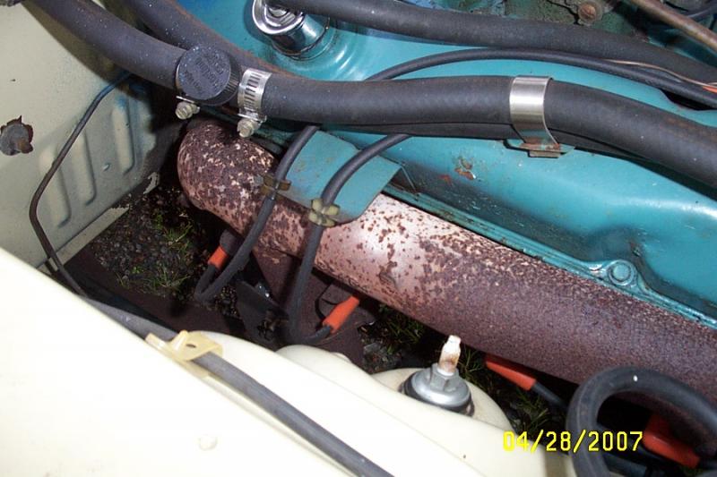

I went to NAPA and purchased the correct orange plug boots, 6 angled and 2 straight. Got the correct dist cap boots as well angled and straight also...and made my own wire set for my 66 383
