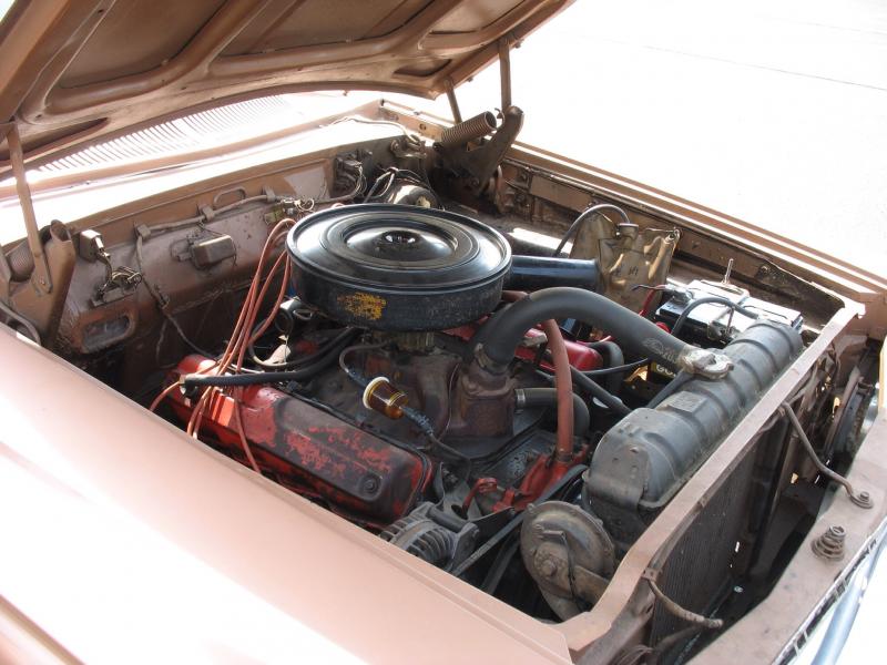

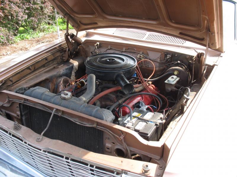

Hi all,
ive been trying to identify the engine I'm my sport fury and I'm all out of thoughts. I can't seem to locate the block stamp. Maybe I'm looking in the wrong place. Anyways I though it was a 383 originally due to 383 being stamped on the intake manifold. But the carb is 2 barrel.
Then I stumbled across this article where they talk about the unique valve covers which seem to match mine exactly. Can anyone help me? I don't have very detailed pictures on hand.
Thanks
jordan
article: http://blog.hemmings.com/index.php/...the-day-1963-plymouth-sport-fury-convertible/ image.jpgimage.jpg
it should br embossed on the driver's side of the block...from appearance...looks like a 318...all small blocks have distributors in the rear...the old hemi's..392 and down also BUT you cant't mistake the heads...all BB had distributor in front so not a 383 for sure...or 361...or 440...426
I believe these "poly 318" engines are actually a different family than the LA engine family that's so common in late 60s to 70s Mopars. Some people call them big block 318s.
The early small blocks are 'A' engines.....

DocAtDug, The block stamp you are looking for is located on the front/top of the block at # 1 cylinder just below the head. Your engine is an A-318 Polyspherical head engine and appears to be original to the car. For 1963 the block stamp would start with T318.

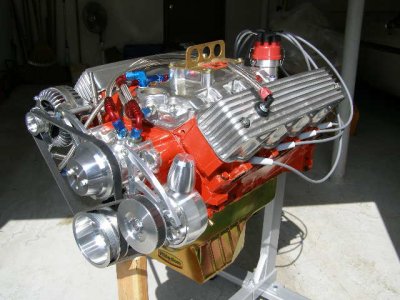

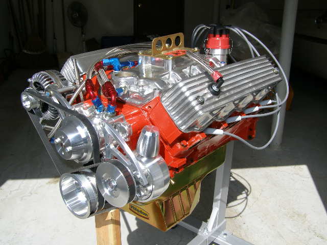

My '63 Fury runs a 359 cu.in. Poly stroker making 392hp, one of the best engines I've ever had...Nick T.

Those are some wicked valve covers! Where on earth did you find them?

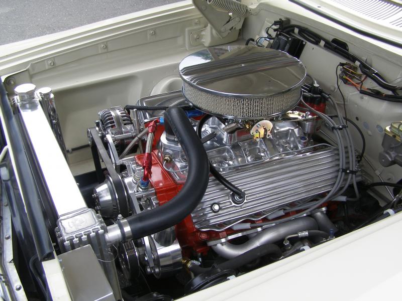

Just a few photos, I had a 64 Belvedere Poly with a Weiand intake, 600 Edelbrock, and TTI headers and exhaust. Just those few changes made a big improvement.I'm sorry I ever let it go. Check out Chrysler Power Magazine,they have intakes, cams,valve covers and more for the Poly.
