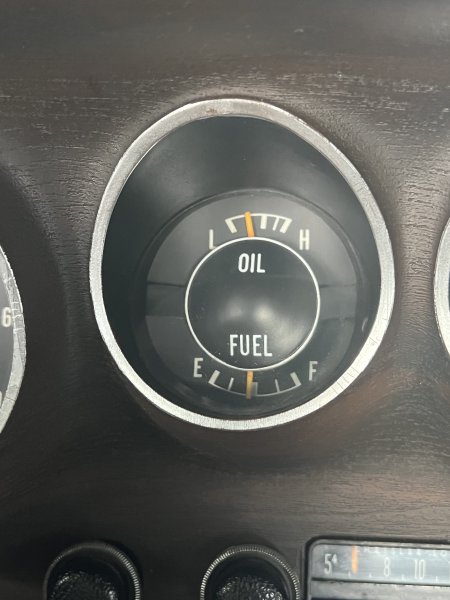

Possible low oil pressure issue in 74 road runner 318…Can someone help tell me if this aftermarket gauge is electric or mechanical?

For the heck of it I went down to the local auto parts store and bought a new sending unit. The gauge needle is sitting at the first dash line (picture below) after running for about 30minutes.

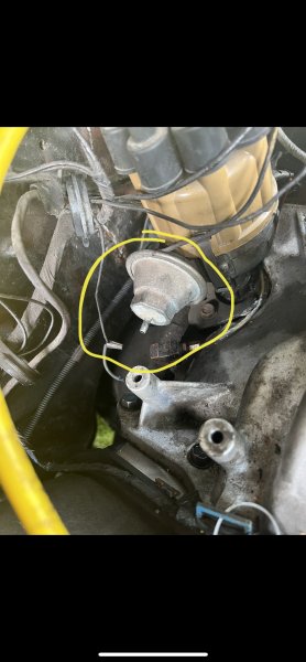

Really appreciate all the information and help! While I was back there replacing the sending unit I noticed (distbributor caps and carbs are new to me so bear with me) what I believe is maybe some type of filter hanging off the distributor cap without a hose on it…circled below. It should have a hose on it right?

Vacuum advance and a hose go to the carb. When you buy hose say it's for vacuum, wrong type hose can collapse. On oil pressure run it.
