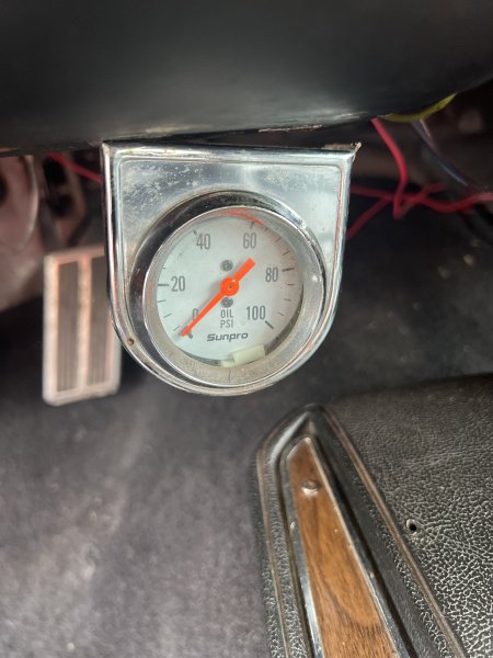

Possible low oil pressure issue in 74 road runner 318…Can someone help tell me if this aftermarket gauge is electric or mechanical?

If you’d like to skip my essay below I’m just looking to see if you can tell from my pictures if I have a mechanical or electric gauge. And if I can just swap in an autometer gauge or if I need to replace the whole setup….would I need to replace the oil sending unit too?

Sorry for the long post but all this leads me to wanting to replace with a quality autometer gauge but I’m new to adding gauges to car. Can I just swap the two out and use the same wires? Can you tell from my pictures below if I have electronic or mechanical? I’ve included the original garage picture too but the oil and temp gauge don’t seem to move much
The aftermarket gauge is mechanical, the dash mounted gauge is electrical... The sending unit is obviously electrical & I don't see a Tee with a line feeding the mechanical gauge.... But my eyes aren't as good as the use to be & the photo isn't great either.... Is there a Tee?
Okay, after re-reading the post, Why not get the OE gauge working.... First temporarily put a trusted test gauge on it & see what you really have for oil pressure, then just use the stock guage..
You have both. Someone teed off the oil line from the factory sending unit and added a mechanical one. Sometimes you need to bleed the air out of the line. Be very careful if you decide to bleed it or you will have a big mess! A deep bucket filled with paper towels will prevent it from splashing. Do not start the car just crank it. Disconnect the distributor to coil wire.

Thanks for all the responses and information everyone. I wound up getting this car for such a good price that even I needed to put a new engine in it I'd still be happy. It turned out to be much more solid than I expected. I'm almost positive that there isn't an oil pressure issue. I don't believe the previous owner did anything with the car (let alone put these gauges in). He just knew that he shouldn't run it if the gauge said 0. I think the gauge is trash. I'd love to just get the original gauge working but lets see if it truly has an oil pressure issue first. Off to learn how to use an oil pressure checking kit.

Thanks. This makes a lot of sense. I’ll see what the pressure kit shows. At idle with the regular oil or 20w 50 it’s right around 20-25 in the mechanical gauge. When I give it some gas it gets up to about 40 and then back down to 20 at idle. The gauge itself has broken pieces of plastic in the lens. After awhile the gauge needle seems to just stop working and will drop to 0. I’ll shut the car off and it’s stuck at 15, I tap it and it drops to 0.
I misunderstood earlier posts then. I thought it was zero with regular oil and 20 with 20w 50.
That's good - that is exactly the behavior you want.
OK, so based on this (and maybe I missed it earlier - sorry) then, yes, it seems to be your gauge. but when the mechanical gauge drops to zero, what does the slow dash gauge do? does it drop to near zero too?
Regardless, get a replacement gauge and see how it behaves. Your engine might be just fine.

Alright so I hooked it up to the T. So I had both the harbor freight test gauge and cheap mechanical sunpro gauge hooked up (just ordered a nice autometer). It seemed like the mechanical one in the car wasn’t on very well so I tightened it down.
Anyways on start both gauges were above 45 psi. After it warmed up I let it sit and idle for about 30-40 minutes, the harbor freight was solid at 12 psi and the sunpro was solid at 18psi. If I gave it some gas it would jump to 25-35 psi.
I feel like the harbor freight being in the 10-15 psi range is low at idle when hot (though I read something online that said Plymouth/dodge originally stated it should be below 6-8 psi). The sunpro after it was tighten down was in the 20 range the whole time.
I guess we’ll see after I get the autometer. I’m still tempted to pull the T out and hook the gauge up so it’s the only thing connected. Not sure what you think of the current numbers it’s giving me. But it never dropped to 0 like the guy I bought it from was saying.
