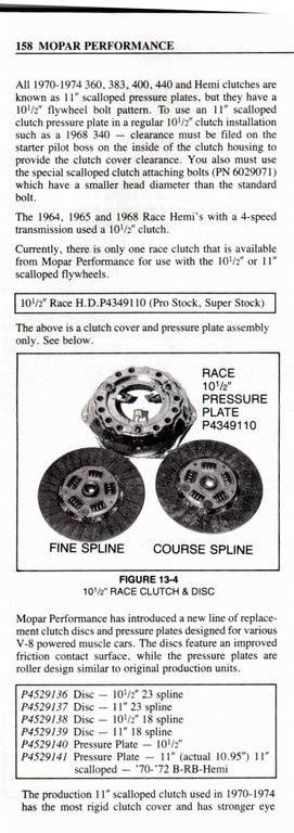

I want a replacement flywheel, 130 tooth and 11" (or 10.5?)
For reference..............
