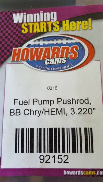

If the pressure is less than what it use to be, pull the pump before it gets any worse and measure the pushrod. 3.220 is the measurement.

Sadly, I know that rod measurement all too well....

Doubt the cam. I have one new in the bubble pac that has the "Tipped" ends. I think it's going to the next swap meet.

The bronze tip pushrod is for use with a roller cam (steel camshaft). This is the one I'm useing.

This thread got me thinking. I have a 78 440 motor home block at the machine shop right now. The engine had 50000 miles on it. Very little wear at tear down. I went and measured the fuel pump push rod, measured 3.221. I have no reason to believe it is not original.
