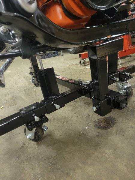

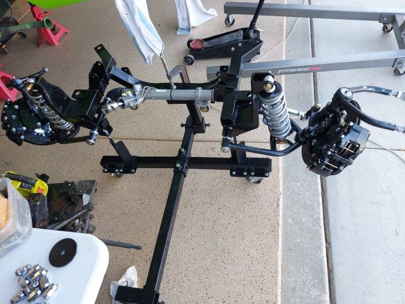

I have the US Car Tools K-Frame engine and transmission stand/dolly and the Alterkation square tubular K-Frame. Also have the adapters from US Car Tools for the Alterkation suspension.
I'm trying to get the suspension on the dolly to drop it out.
For the life of me I don't understand how it attaches. The adapters are VERY loose fitting to the K-Frame.
I just don't get it.....here's some pictures.
Adapter...

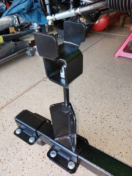

Front support...don't understand it's use...!
See how much of a gap there is....I doubt it's "wrong", I just don't get it...
Anybody ever done or have a picture or anything?

Their website shows the adapters rotated 90 degrees
You will receive two (2) adapters and they mount on the top of the K-frame stand uprights, this permits any square or round tube member of the aftermarket K-frame to be supported by the USCT Motorsports K-frame stand.
Where you have the stand is out by the sway bar mounts it looks like.

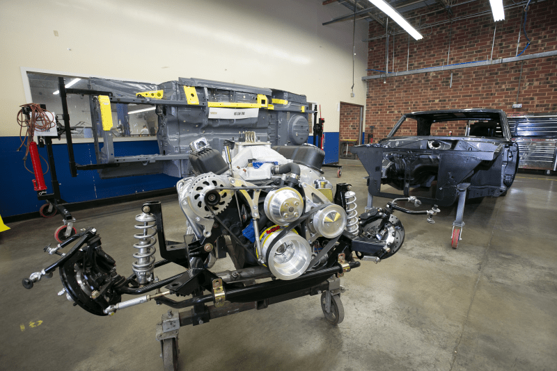

I did find this picture and the stand is further back than you have.
And maybe then the front support is adjusted to catch the front cross bar of the K member ?
Maybe a call to them would help as I am totally guessing.

You could line that adapter with some thick rubber to shrink it and protect your K-frame paint?
Mike
The front support is for a stock k member. But possibly would work for yours? Maybe slide the whole thing back and re adjust. Need better pics of what you're doing
The front support is for a stock k member. But possibly would work for yours? Maybe slide the whole thing back and re adjust. Need better pics of what you're doing View attachment 1379124
There's tons of great pictures of it with the stock suspension. ...nothing for using the adapters with the Alterkation setup....
