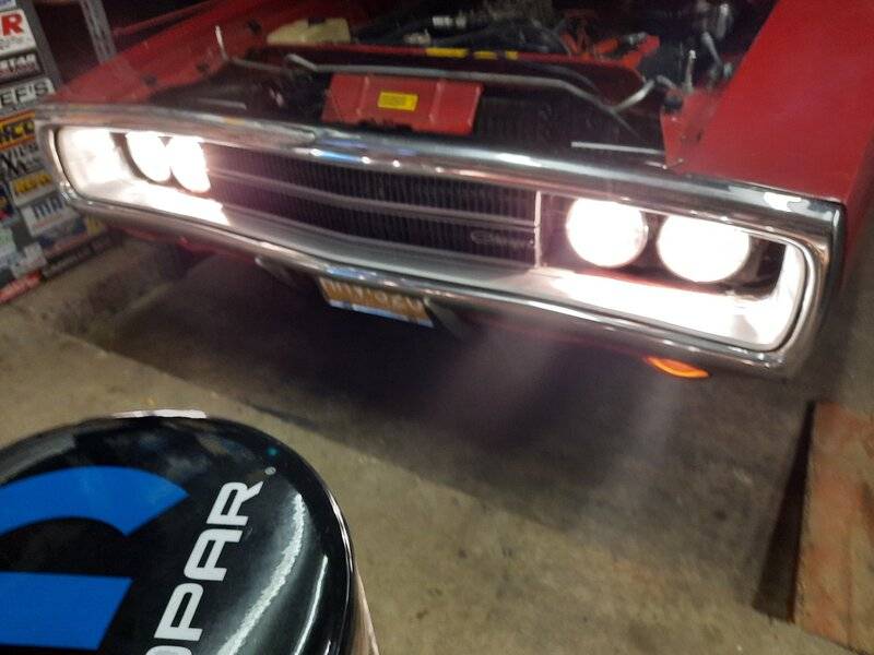

No need. I did crackedbacks plug and play conversion relay kit on my 70' Charger. Factory headlights are twice as bright as they used to be.

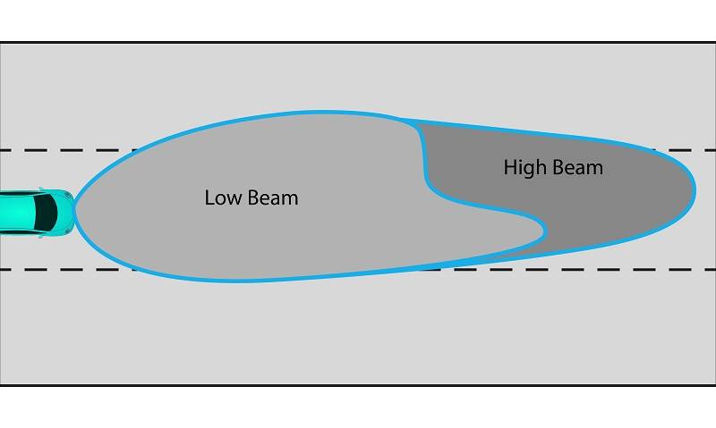

I've used Hella for years, the light bean is sort of Z shaped so further out it lights the whole road and allot of the right edge/shoulder... As oncoming traffic gets closer the majority of the light is focused toward the shoulder...

Okay, that gives you quality lenses but halogen, halogen works pretty well but draws more power and creates allot more heat... If you want LED all you need to do is swap out the bulbs... Personally I'm still running Halogens H4's with relays, I don't need more than that...

Being HELLA an European brand where by regulations the ligh beam must be focused more to the right road shoulder I find logical you got that. That's for LHD cars. RHD cars ( UK ) gets the opposite beam shape.
