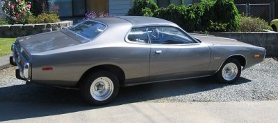

I Put a 318 out of 86 diplomat into my 73 dodge charger 8 years ago. i started with a $25 tool kit. 6 months later i was back on the road..with a slightly larger tool assortment. i was so excited that it actually ran that i feel there are alot of things i didnt consider or research so it has never really been to reliable. Nowadays i have the time and means.to work on it i started thinking.. i have been trying to work on it as a 73 318. there are no sensors on the engine and i've always had issues with the vacuum and cooling.. is it because this is not a 73 motor. I had thought that the only difference was the roller rockers and roller cam. but after banging my head off the hood a few times because i can't seem to make it run right, i thought well the compression, air flow, cooling and timing would all be different..wouldn't they? My question is what now... Ideally i just want 300hp and a reliable car. Can i do that with this motor? do i do it as a 73 or an 86. Do i look for an older era correct motor or do i buy a crate motor.
I give thanks in advance to anyone willing to guide me.. I truly enjoy working on my car but there is alot i still have to learn.
