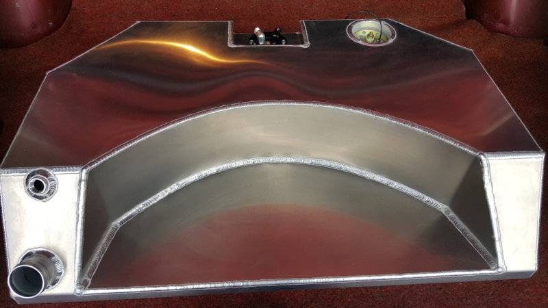

Hot Rod City garage makes baffled tanks, with internal pumps for 67 Coronets, had mine almost two years no problems.

Hot Rod City garage makes baffled tanks, with internal pumps for 67 Coronets, had mine almost two years no problems. View attachment 901126

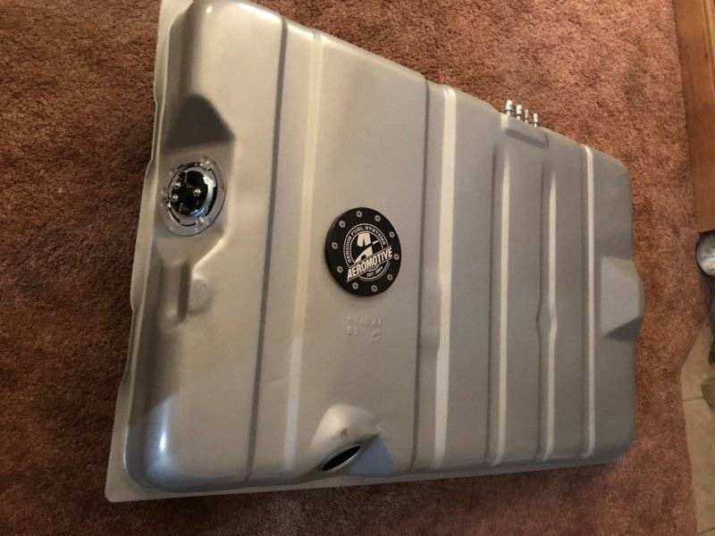

I saw a post about them, tried contacting them for about a yr. No return messages or emails. Finally gave up. Not sure on their price, but out of principle, if running an external pump doesn't work, I'll be going with the Aeromotive tank. Thanks for the suggestion though.
They are not cheap, seem to remember that they were over $400. they are very nice units to be sure but you can get a tank and a pump from Tanks Inc. for $500. Knowing what I do after having installed a few EFI systems, I would either buy an EFI ready tank (if available) or I would modify a stock tank for either an in tank pump or just run an external. Any of them will work, there are pros and cons for everything but in this area most of the issues are relatively minor.
