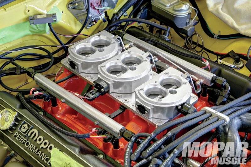

Starts at $2,650 for the 3x2 TBI/EFI setup plus the cost of the controller, for example the FAST’s XFI or EZ-EFI systems.
UP TO 2,300 CFM!
(I almost don't want to share articles like these, because that means more people will get them) :poke::D
https://www.hotrod.com/articles/how-to-install-the-f-b-throttle-body-with-efi-electronic-squirting/

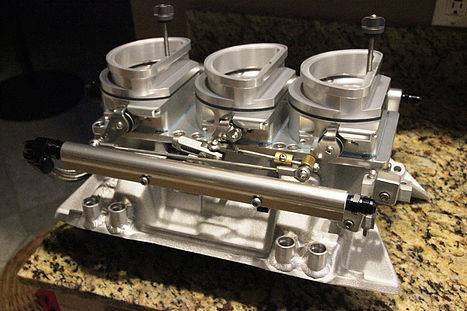

Ugh. I’d find an old set of carbs for throttle bodies and build it for a fraction of that.
Nice valuable skill if you have it...Fun too I'm sure!
I'm handy with mechanical and electrical stuff. I work on medical equipment for a living. Maybe once I'm semi retired or retired I can mess around with stuff like that and who knows what else, but for now, I'm better off buying stuff that is ready to go and have tech support to back me up if I need it. If I don't work, work doesn't get done, so often it costs less for me to pay for things than to spend time doing it and not working.
