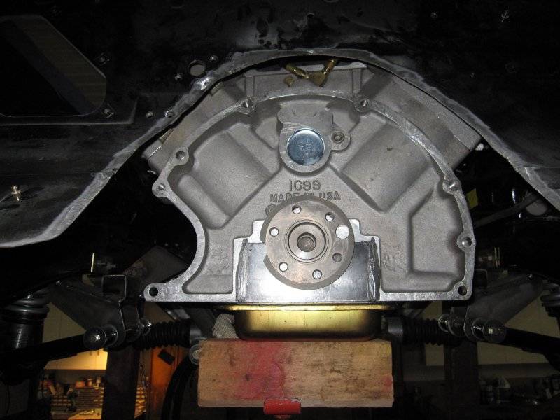

I have a coolant leak showing on the bottom of the transmission converter housing. It has wetted the threads of the right side 7/16 bolt and even shows one drop on the edge of the flex plate. The right side up to the cylinder head looks dry. I am using Mopar antifreeze which is pink so I thought I had a transmission leak, until closer examination. I have pressured the system and it held 15#s for a couple hours so I know it is a small leak. Any ideas?
Mike
Tough call. Let it sit with no pressure and see what happens.
Any chance it could be at the deck/head gasket and seeping back & down to the 7/16 trans mounting bolt?
