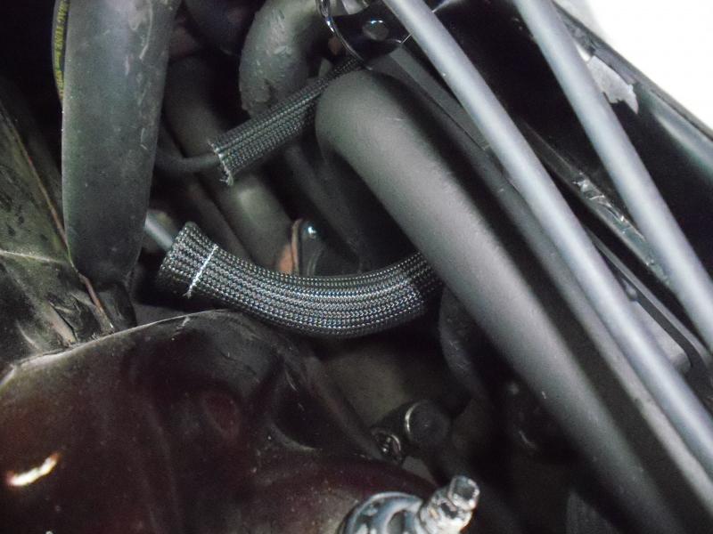

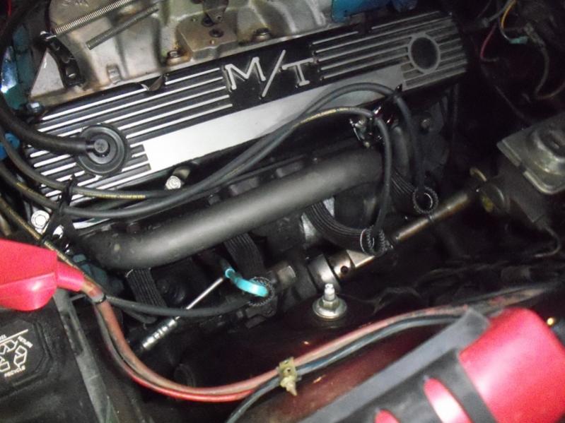

Mt TTI's cracked and I went with these on my 65 Satellite with auto and 440. They sound really good and I'm well pleased. They are so easy o install
