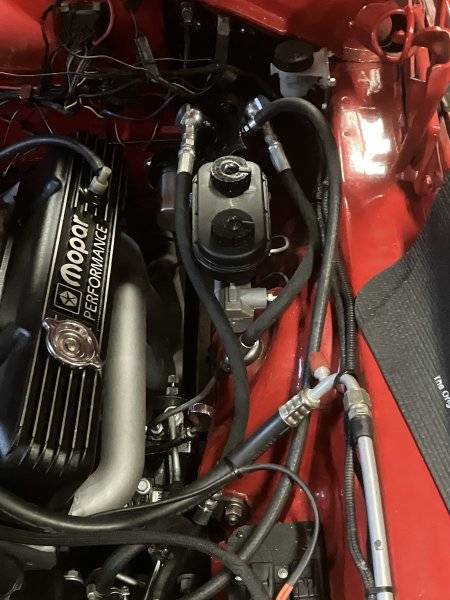

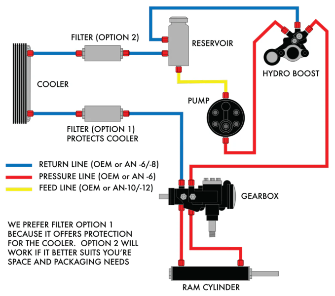

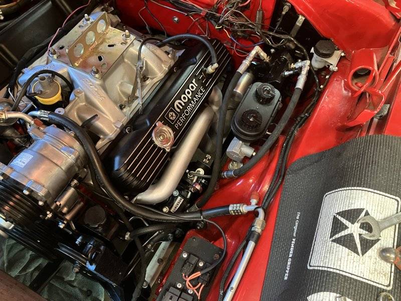

I'm in the process of putting Hydro boost on my 71 Charger.
I'm seeing concerns that the Saginaw pump is not up to powering both the power steering & the hydro boost pump.
Is it a pressure issue, or a fluid volume/capacity issue?
Could it be a problem with the fluid becoming aerated?
I'm not working from a kit but have assembled my own system with help from a friend that built his own system for his big block Chevelle.
His brakes & power steering work just fine at any speed. Brakes especially.
He put a bulkhead fitting in the power steering pump housing for a 2nd return line.
One other thing he did was use the transmission cooler already mounted to the front of his radiator as the power steering fluid cooler.
Could the extra capacity from the transmission cooler be helping this issue?
