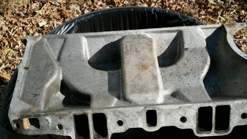

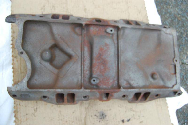

WHat intake? Are there holes in the ends for the guide pins in the china walls? Here's a stock intake. See the holes? The bottom is a LD4B with a mark where the pin is but no hole.
