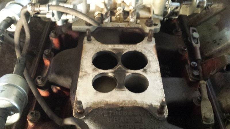

Not the greatest picture, but this shows that mine are mostly Allens with 2 studs/nuts and at least one hex. The assembly date was April of '66.
That looks similar to the AMK 66/67 kit I bought except that the 4 corner fasteners were also studs with hex nuts, 6 altogether. It wouldn’t be the first less than totally correct part I’ve bought for the car though.
