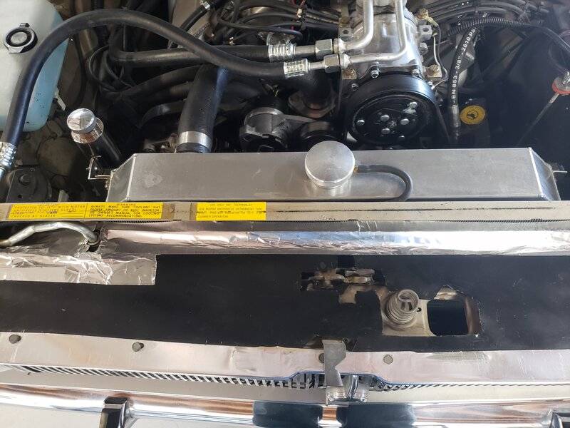

I've got stacked plate trans cooler and my condenser is a modern parallel condenser from vintage air. But it is sbout 1-1/2" away from radiator. However, I put a sheetmetal cowl across top of core support, and sheetmetal on both sides of grill opening funneling air to the radiator. Everything is metal duct taped around edges. No air can escape from that area. It has to go through the radiator.
Do you have electric fans? I am assuming you do.. if you do, when do they come on? if you are having issue at highway speeds it would seem that the air is being slowed down through the radiator. which style of fan do you have pullers or pushers? and what brand? stupid question are they wired for the correct direction? i would think at highway speeds, the water should flow through the radiator fine since the pump is pumping faster and it cools at idle. and i am assuming that you are not at 4000rpm on the highway. so, i am going towards air flow, can you post a couple pix of your setup?

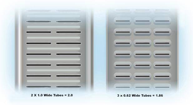

In the old days of copper and brass radiators this was true. More rows meant more surface area in contact with the fin and consequently a higher heat rejection. So a 3 row was better than a two row and so on.
When aluminum radiators came around the rules changed. Cooling engineers concluded that by lowering the fin height you could stack more layers of tubes. In addition, using wider tubes would increase the tube-to-fin contact area. The end result was a very high performance radiator with a huge savings in weight.
The U.S. standard for performance aluminum radiator tubes is a 1.0" wide tube and imported radiators have smaller 16mm (.62") tubes. In this case a 3-Row aluminum radiator would only have a total of 1.86" of tube-to-fin contact surface which is less than the two row core with 1" tubes. The online ads for these 3-Row aluminum radiators will indicate several features of the radiator design but they avoid the issue of the tube width. DeWitts radiator goes another step and offers a two row core with 1.25" tubes or (2.5") tube-to-fin contact and this would again exceed the performance of a 4-row imported core design. So, if you are researching your next purchase ask about the tube width. That will tell you a lot about the heat rejection and the origin of the product.
Exactly. More rows do not equal more cooling. Two one inch tubes will cool better than three smaller tubes.

I built a sheetmetal shroud that covers the entire top from core support to where the grill attaches. Put side shrouds from the edges of the grill opening to the radiator core opening and covered the the bottom opening You mentioned. The air cannot go anywhere but through the radiator.

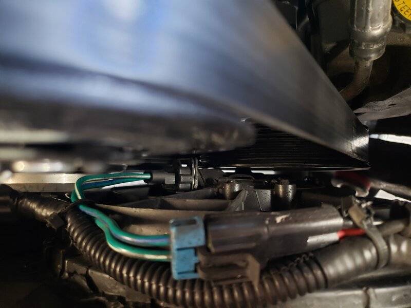

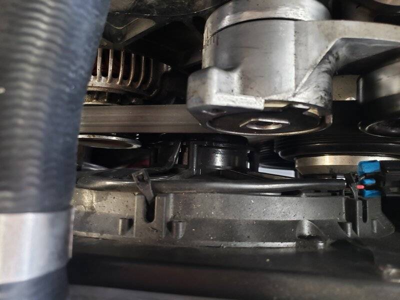

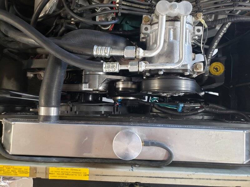

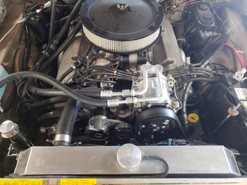

Here's my set up. Hard to see due to space.
