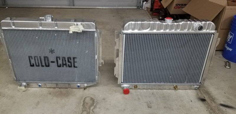

The looks---
Cold Case advertises their unit as "if painted black, only a real Mopar expert could tell the difference between ours and a stock unit"....
See pics. You make the call.

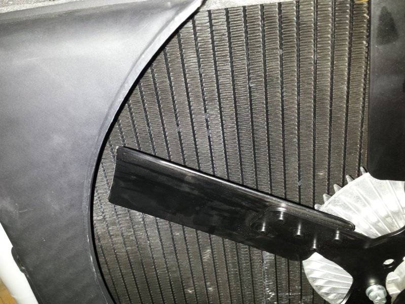

Both have extra flange material that sticks out beyond the shroud.
In the picture, I had already trimmed the shroud brackets on the Cold Case and cut and re-TiG welded the front mounting brackets to move them back to allow more clearance to the fan (hey that's precious space!!) but that's just a personal thing.
I don't care for extra flange material jutting out beyond the shroud.
ACC is un-modified in picture other than a sharpie line where I ended up cutting the shroud flanges.

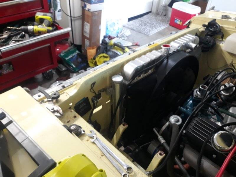

I did add a shroud after pic was taken, and sorry I don't have a better picture. ruffcut

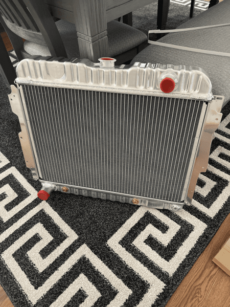

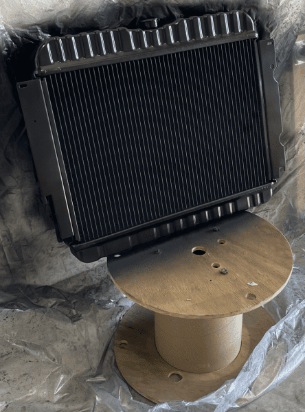

This thread isn't that old so I'll revive it a little bit. I decided after struggling with keeping the 440 cool in slower traffic situations with the current ACC radiator (small block style but claimed for BB), that I am going to upgrade my cooling game and I am using this thread as a reference. I was considering a Cold Case, but you can't beat the appearance of the ACC.
After being out of stock for ages, and then told by Auto City Classic (ACC) that they "no longer ship to Canada" or anywhere outside of the 48, had to get slightly crafty! :fool: More than one way to skin this cat.
I have a great PO Box service in Sumas WA that will bring anything I want over the border for a reasonable cost, so on Friday morning, a glorious 26" ACC radiator arrived in Abbotsford for me to pickup!
I will be using the shroud that @beanhead & @gtx6970 used and a stock direct drive 7 blade fan (when I find a decent one). Painted it high heat satin black for that OEM style appearance.
Happy that the first piece of the winter projects has arrived, and thanks again @beanhead for the awesome review to help with decision making. :thankyou:

View attachment 1523350 View attachment 1523351
The only thing you will need to do is enlarge the shroud mounting holes to accept the clip nuts. I just replaced my ACC with another ACC. They work great. My old one had 5 years and a ton of crud from the engine. Better off getting a new one.
