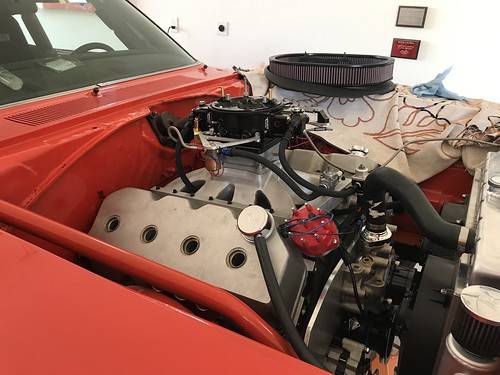

It does. I use the SD Meziere electric pump. I can drop the temps from 180 to the 1-teens in a matter of seconds by leaving the fans and pump on after I shut off the engine. The bypass mod also helps.

I missed the part of your post that stated you only wanted replies from daily drivers that put 100+ miles a day in 115+ temps. No, I prefer the vented seats in my 2500 Cummins for that. This set up does keep my 605 Hemi <180 during the 115+ temps.
