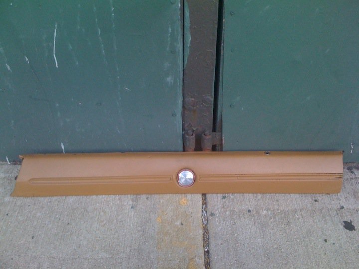

Here is my problem. This is my 69 Dodge Charger, front and rear upper and lower door panels. The upholster shop told me, that because my upper door pad/molding has a design in it, that he could not reproduce that, and if I go and re-upholster it would bring the value down of the car. Can I buy the same fabric with the design ? Here is a picture of what I mean. If you see how it's ribbed, he says that cannot be reproduced, unless you buy the material the same way. The edges of this upper door molding are ripped which you cannot see in the photo, only reason why I want to repair / re-upholster it.
Yeah, I agree with them because of the ribbed pattern. I would say a vinyl repair kit and alot of patience.
