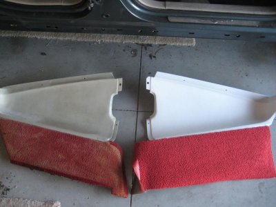

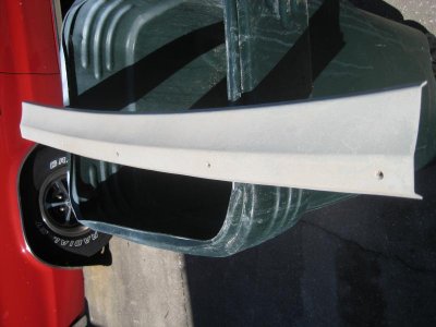

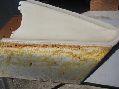

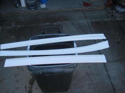

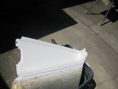

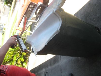

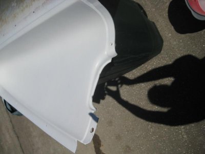

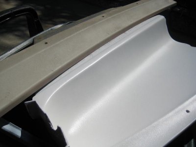

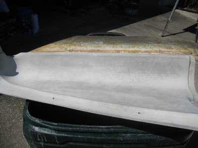

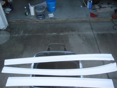

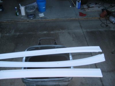

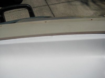

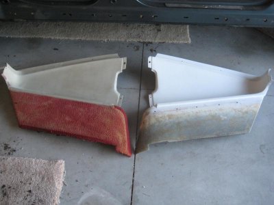

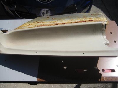

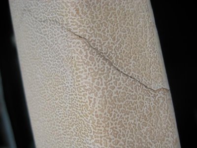

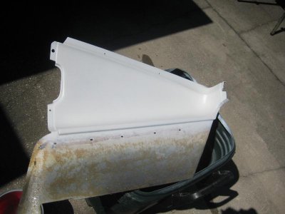

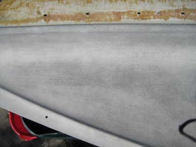

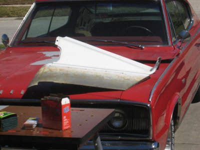

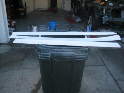

Happytoes and i spent today starting the restoration on the interior trim in the Charger. Since the seats were reupholstered we need to restore the other pieces. So it all looks good. We used Zep degreaser, scothbrite pads, steel wool, xylene and a lot of elbow grease. Once all cleaned, I sprayed them with SEM Color Coat Sail Cloth White. I'll use this thread to chronicle the restoration of the interior. We'll be back at it tomorrow. :)

When i cleaned the rear door panels in the sun they had a pearl quality and sheen to them. But for painting them it's just SEM Sailcloth White 15603 in spray cans. I bought 5 cans and have 2 left. But I still need to do the front door panels and the panels on the front seats. So far in total with the paint and cleaning supplies it's about $200. I have a quote from the place that did my seat upholstery for 2k to dye/paint the panels and recover the door panels. I figured if i messed it up I would only be spending 10% more to have them do it. So far so good.

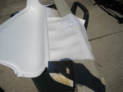

Well, be careful how you clean paint off of the front seat backs. Since the seat backs seemed like they painted with the same paint color as the other trim pieces. I decided to use paint stripper to get the paint off the seat backs. Because i thought the backs were metal. well they are, metal covered with vinyl or something vinyl like. so the vinyl bubbled and started to peel off. So i used the paint stripper to strip the vinyl off. So after some minor chemical burns from the stripper. I got the stripped and cleaned up. I bought a 24"x 60" piece of vinyl wrap that looks like white carbon fiber. it's hard to tell in the pictures that it looks like carbon fiber. Not bad for our (happytoes and I) first time using vinyl wrap. The vinyl wrap cast about 40 bucks on eBay. Well worth the cost.

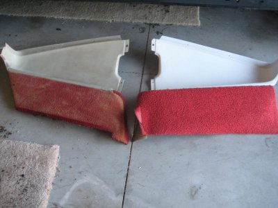

On another note the carpet for the Charger is a PITA. I think when the interior were changed to white the previous owner must have had an upholstery shop do it. I say that because the carpet pieces in the ACC kit I got in some places dont seem to come close to matching the carpet I removed. I think the pieces that were on it were custom cut. The old carpet peices had greater coverage on the panels. In many places they wrapped around the panel. The big trouble spot is the carpet on the back pieces and how where they fit to match up with the back door panels. If I dont get it right I'll have a big bald spot where they come together.
Thanks to my beautiful wife (happytoes) and her sewing machine the edges that have vinyl are sewed down making really nice edges. The front seat backs have the carpet glued down. So I am once step closer to finishing the front seats.
